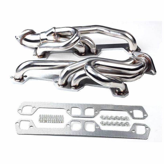

Pickup/Van/Dakota (same part for all three vehicles) – the Magnum exhaust manifolds exit where the firewall currently resides at. I would think the headers pictured above would have the same problem.
Now, Jeep Grand Cherokee Magnum exhaust manifolds exit more to what the FMJ small block manifolds exit at – so I would “think” they would be more likely to fit your car, more than the pickup version does.

If going with pre ’73 or with Magnum cylinder heads – you don’t have much to worry about with either headers or Magnum exhaust manifolds. The post ’74 up to Magnum cylinder heads have A.I.R. ports that will need to be taken into consideration – otherwise.
Now Jeep Grand Cherokee Magnum exhaust manifolds exit more to what the FMJ small block manifolds exit at – so I would “think” they would be more likely to fit your car more than the pickup version does.
Thanks, I'm just going to hold out till closer to time for head swap.

Mmm Hmm!! Sexy! Did they discontinue there $900 ceramic coated headers now? Id never buy chrome but ceramic is really a necessity.
