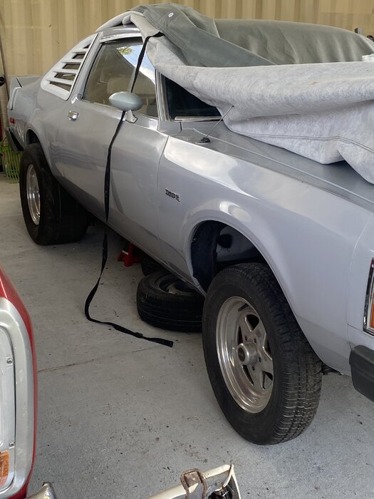

I have the car coming along nice. 360 in the machine shop. Question for everyone, what front shocks are y’all using?
