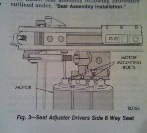

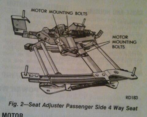

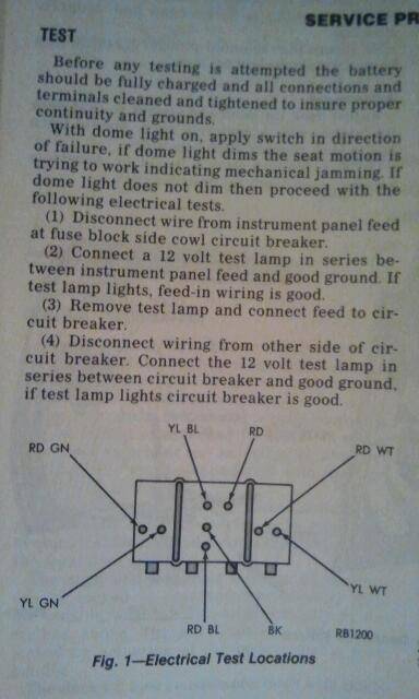

What I can give you is everything I have in my 86 FSM on power seats.
Hope this helps....
