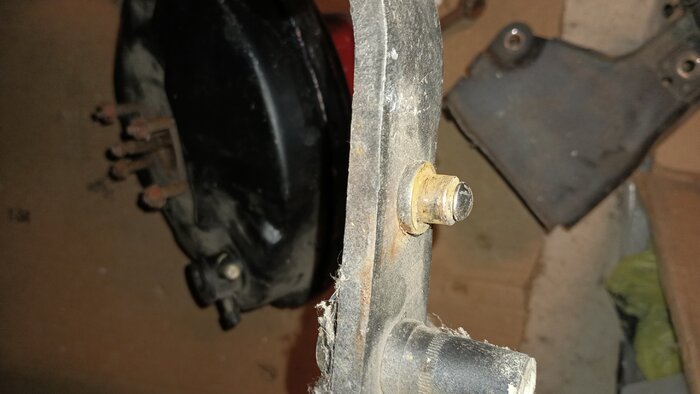

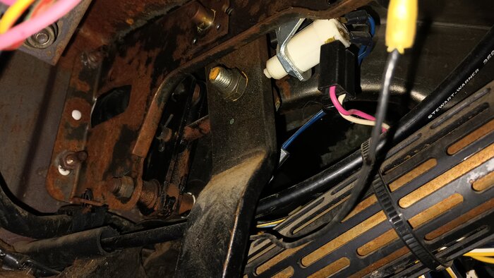

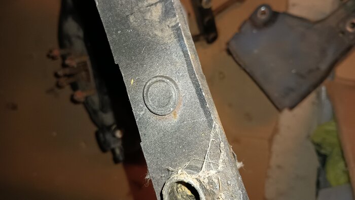

I purchased an in-line tube brake line kit which was designed for a boosted setting. I installed a power brake booster not realizing that the new push rod location would not match the original brake pedal. I purchased a power brake booster swivel linkage for a 70-74 e body…they don’t seem to make one for an f-body. However, the included piece that connects to the brake pedal is not long enough. Any suggestions on how to connect the old brake pedal to the new brake booster?

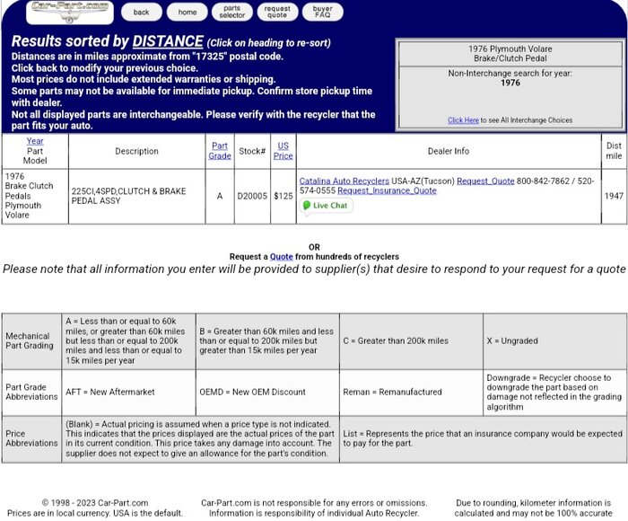

If it's a pedal alignment problem, maybe someone here will know if this will work

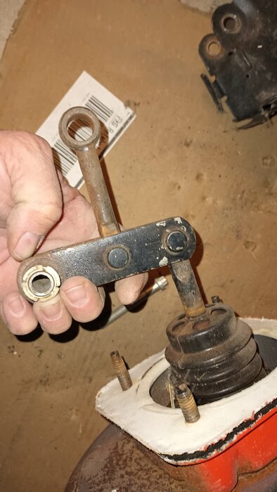

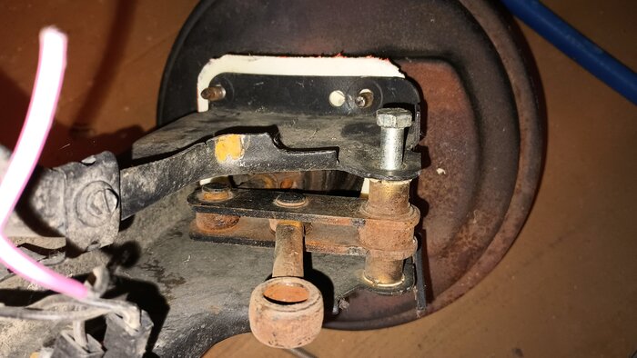

If by chance you started with a manual trans pedal setup and are in a pinch you can knock out the pin and use the shoulder type bolt like in the first pic I posted in the prior post. There is also a slightly different pivot arm also used but that might cause more confusion. But the pics show oem setup. Your manual setup simply had a rod from the master to the pedal, power is way different.

You need the pedal converter that XfbodyX showed. But look into the K car booster conversion. Smaller and I find it more effective.
