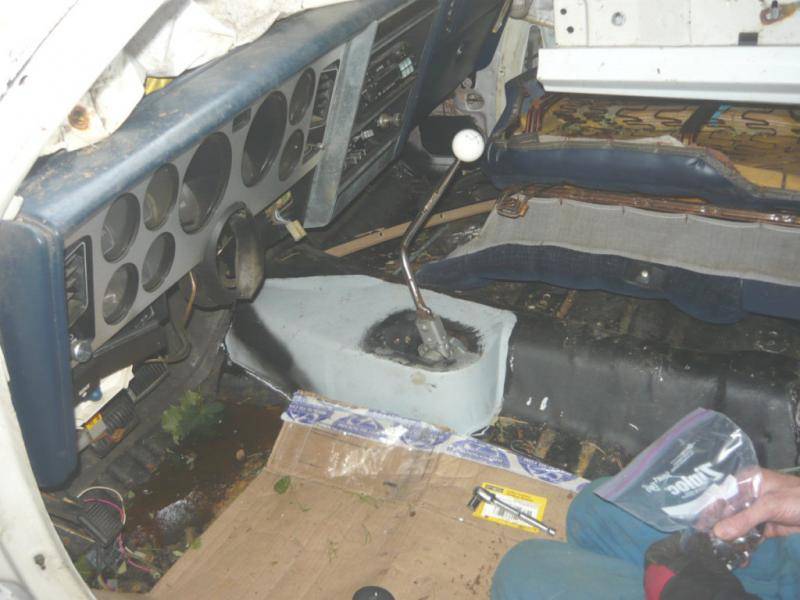

I don't have it driveable yet, but I mocked up the 4 speed for my 80 Mirada. I needed an F body floor hump, pedals, Z bar and pivot, and clutch rod. The trans, shifter and rods are '69 A body. It's pretty much a bolt in deal, the floor hump fits perfect and the hole for the clutch rod is already in the firewall. You have to modify the pedal bracket a little to accept the clutch pedal and reinforcement, and drill 2 extra holes in the firewall but it's no big deal. I may modify the shifter a bit as it's a bit close to the dash in 1st and 3rd.
For now I'm just going to take the shifter out of the auto column, but I'd like to get a floor shift column eventually. I bought a new carpet set that I'm hoping will be wide enough make up for extra the floor hump width too.

This car had a 60/40 bench but I'm planning to use the buckets from my other Mirada with the little center jump seat if possible. I'm thinking the 4 speed hump or shifter might interfere with a 60/40 seat, but maybe not if the seat is adjusted back enough.

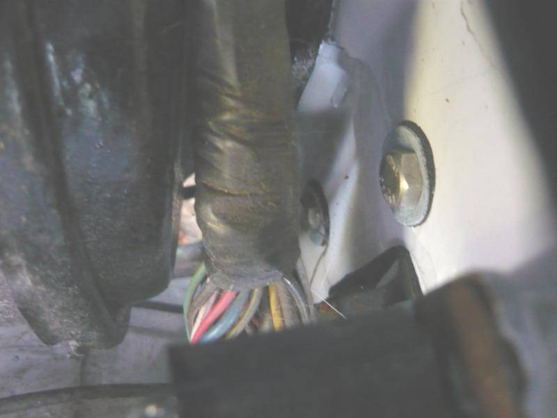

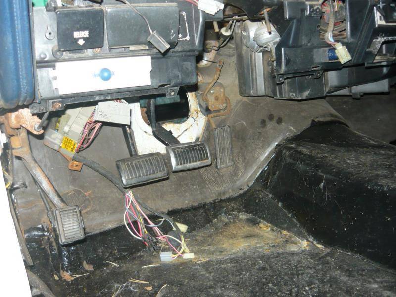

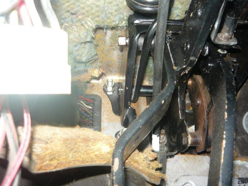

If you look close at the above pic the pedals are already in the car but I took a couple of pics today, excuse the dirt the car hasn't had any glass in it for a while.
The over-center spring interferes with the fuse box a little, that's why it's hanging down, I just have to move it slightly. I'm still trying to find a chrome bezel for the clutch pedal too.
This is looking up, the clutch and brake pedal hang from the same longer bolt the manual trans cars use, and there is a extra reinforcement that helps support the clutch side that gets bolted to the firewall which you can see here. This stuff fits the Mirada pedal support bracket fine, you just have to drill 1 extra hole in the side. You can't just use the F body pedals as-is, because the pedal bracket is too short to meet the J steering column where it bolts to the dash.
Here's where those 2 bolts come out the firewall by the booster. The firewall is already dimpled for the bolts, so you know exactly where to drill. Hope this helps some.
