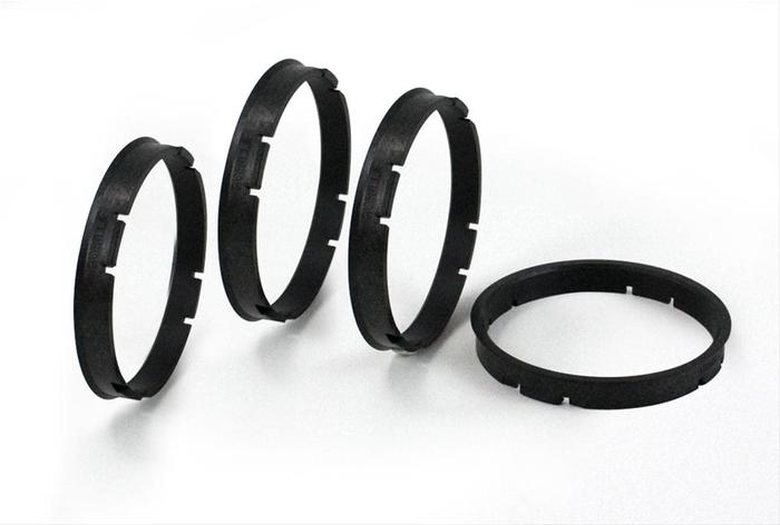

They'd be OK as is but ideally you should get a set of hub centric rings.
Gorilla Hub Centric Rings 70-5710

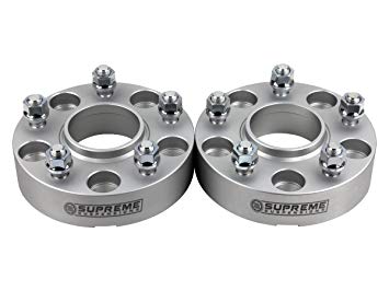

That's the better problem to have (offset too high) because a number of different style wheel spacers exist in the aftermarket.
I've been using Adaptec 19mm thick aluminum hubcentric adapters on my Chevy Sonic for years now without a problem. They helped me lower the effective offset and adapt from a strange Australian 5x105 to the more popular 5x100 bolt circle.
Adaptec is nice because you send them the dimensions (Thickness, bolt circles, hub outer diameter, lug hardware) and they'll build you a set to spec.
