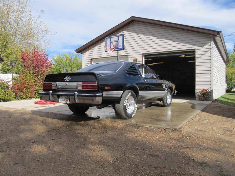

right now I have 28/9/15 slicks on my R/T. I would like to go with a bigger tire. something in the 10.5'' or possible 11'' wide.
I would have to buy 2 new rims and a 10'' rim would work with the correct backspacing.
do I have to mini tub to get this size of tire under my R/T?
as you can see, my 9'' tire looks kinda small.

Im not familiar with the F's, perhaps find the section width and back spacing dimensions of your current rim/ tire combo and then do the same with the new rim/ tire combo. See what hits and what fits.
On the Miradas, the front inside wheel well ( by the front spring hanger) has clearance issues that a sledge hammer can fix. The next issue is the front segment of the leaf spring. Offset spring hangers and offset shackles will help. And the biggest or hardest clearance issue is the frame rail, directly above the axle. You can only move the wheel well or mini tub, 1" as the frame rail is right there. Again, these are 3 clearance issues on a Mirada, but will give you and idea of where to look.

I made my way underneath my R/T last night. I have about 1-1/2" from frame rail to slick. And I got 1/4" from slick to spring.
To move my caltracs, springs over to make room for a different off set rim seems to be pointless. If I do that, the only thing comes to mind is go all the way and ladder bar this puppy up!
Then it's fully tubbed and big 14" slicks. I would like the look but my R/T is not fast enough for that.

A 3.5 bs wheel will fit F body. That would be a 10" wide wheel. Should be able to squeak by with a 10" slick.
