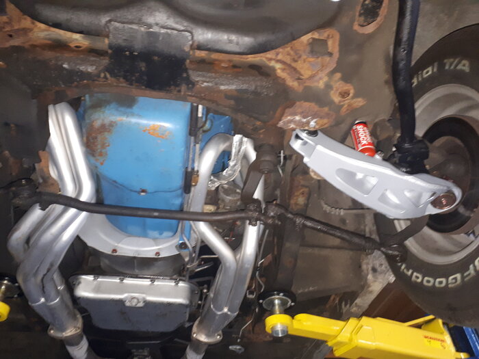

Any header for a A, F/J bodies will fit. With most brands you’ll have to take apart the steering drag link for install except with Dougs headers if I remember correctly. You’ll also likely need a Mopar mini starter for clearance. Definitely don’t need or have to be block huggers, should have more than enough room.

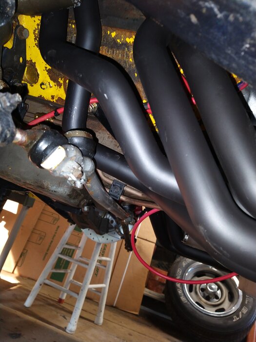

Doug's are quite a bit cheaper than TTI. The biggest problem with most headers is they tend to be made with thin metal. My Doug's were pretty damn heavy compared to all of the other ones I have helped install.

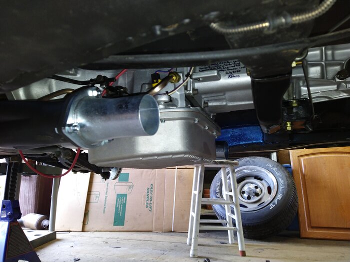

for a starter use one for a early 90's magnum motor. Its a factory mini starter and will only set you back 60 bucks or so. Alot better than paying several hundred

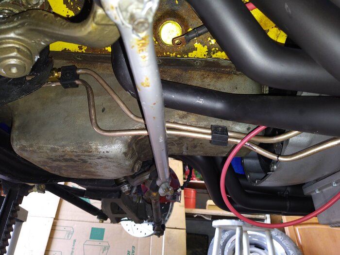

Doug's D453, they are only slightly lower than the steering and trans pan.

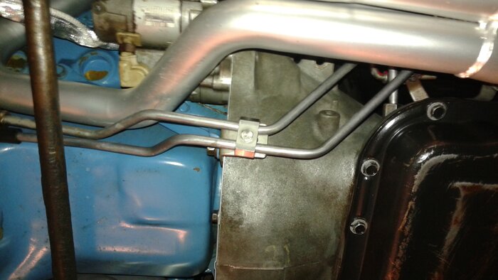

I tried Blackjack and Hedman, neither of which would fit. I went with 340 manifolds for years which require a smaller brake booster. Eventually I tried TTI which fit like a glove. I would definitely recommend them. I was even able to eliminate the oil filter adapter.

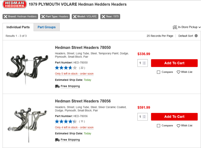

I dont know if some have got complacent with modern tech or old or just lazy but isnt headers one of the first mods we all did at 16 or 17 when cant or wont was not in our vocabulary? Id like to think most of us are still modifiers, fabricators and even innovators. The internet has made us lazy and less dependent on our own skills and free thinking.
Oh... Merry Christmas EVERYONE! Just a two day lag. :cool:
Screenshot 2022-12-27 at 06-07-24 1979 PLYMOUTH VOLARE Hedman Hedders Headers Parts & Accessor...png
