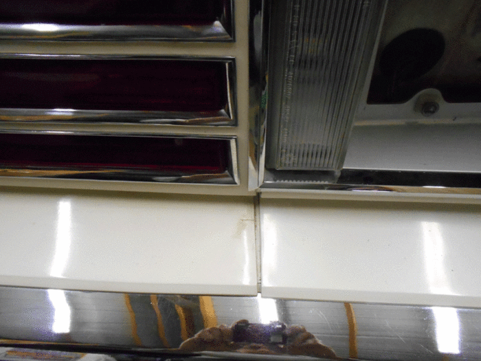

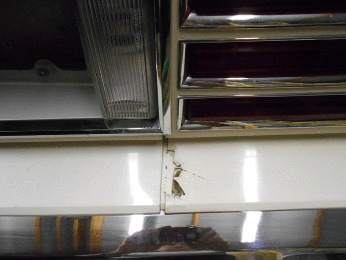

    The caps on my car are in decent shape and it spent its life in WI until June of this year. It still has it's original paint. The caps are still flexible but they're starting to disintegrate where they meet the center piece under the rear license plate. There is a short piece of adhesive to keep the filler pieces stuck together and it looks to be made of some kind of petroleum product (tar) and that's what is causing the problem with mine. I also noticed the caps get a haze on them in the summer, probably from the plastics off-gassing, so I'm wondering how long before they start to crumble. Too bad there's not a good reproduction of these as I think every one of these cars will need them sooner or later.
    Drivers side. Not too bad but it's starting to discolor right under the tail light.
    Pass side. This side didn't do this until I was washing the car and touched the filler panel.
