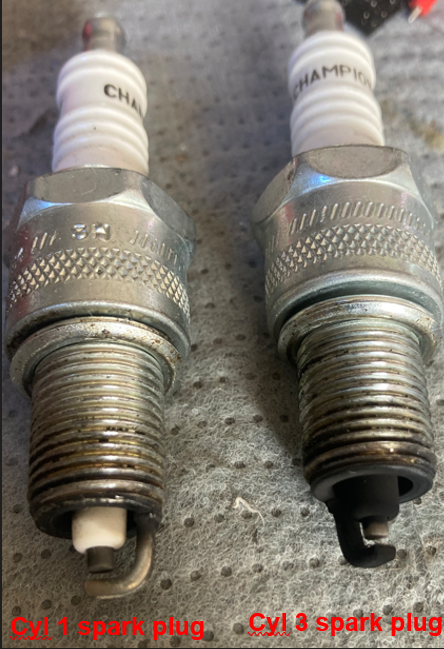

Last but not least I found out that sparks plug came out foulued with carbon (dry), but not all of them only 4 of them in a 1-1 pattern (1 cylinder good and the next 1 faulty) and this happened with the rest of cylinders 1 cylinder good and the very next one faulty. Distributor is brand new (6 months) I already verify gap between reluctor wheel and adjust to 0.008. spark is strong from coil and on to the plugs. Last weekend I disassembled the AVS2 carb just to find a shiny clean interior with no evident obstructions or anything abnormal.

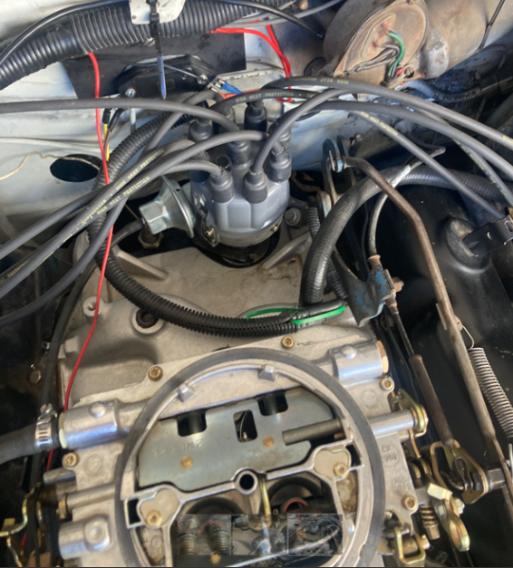

I’ve mixed up the 5 and 7 plug wires and had a similar issue where it would sputter and backfire out of the carb at idle and run seemingly well under load.
Maybe a bad/dirty accelerator pump in the carb. When the engine’s off and the air cleaner’s removed, are you getting good streams of fuel when you hit the throttle on the carb?
I double check firing order its in the right position. About the accelerator pump: only thing that i notice is that the spring its not 100% straight it has a slight curve right in the middle, could this cause problems with the mechanism?

Thats interesting, sparks that came fouled are: 3,4,7 & 8. the rest came out clear this with the fresh set of autolites, and after a 40 min driving downtown and highway.
Still looking to a solution on the fouling sparks pattern I really can figure it out.
I did this too once and would've sworn there was no way I did it; I was wrong!

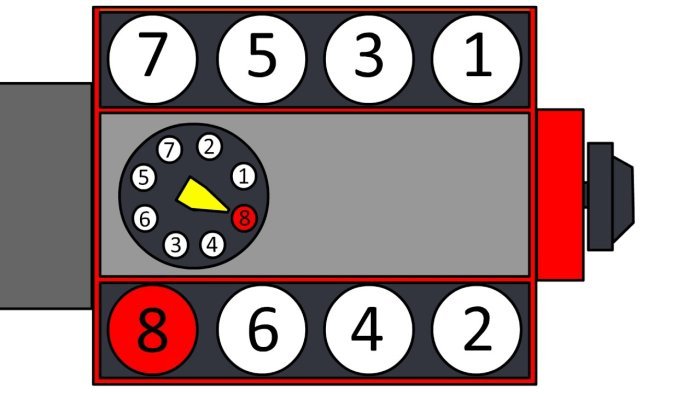

The firing order on a SB Mopar is: 1-8-4-3-6-5-7-2, you found 8-4-3-7 to be fouled...seems like there is a bit of a sequence match here.
Assuming a dual-plane intake here and looking at a Performer RPM intake I see:3-2-5-8 are fed together, as are 1-4-7-6, so the fouling you are seeing doesn't seem to indicate a fuel distribution problem.

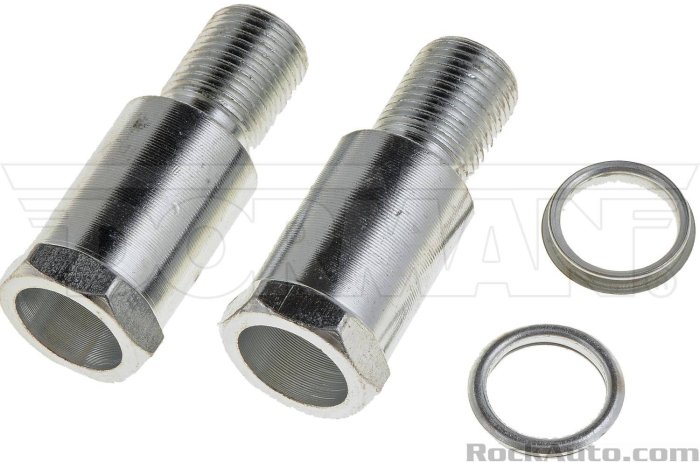

I was thinking about it today and if all else fails you could try an old engine trick and use spark plug non foulers
Interesting I never hear of this piece, ¿How does it works?

You put it in the spark plug hole and then put the spark plug inside it. It keeps the end of the plug from fouling if there's an oil leak in the combustion chamber or blow by in the engine
