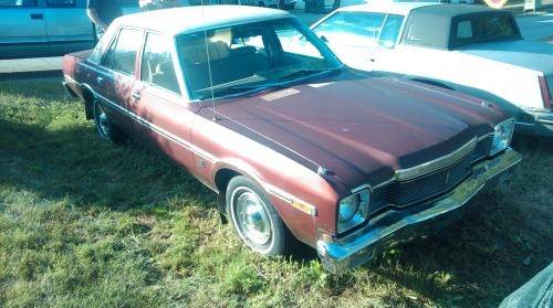

Hi guys im kinda new to the car game, spent most of my time on trucks. A few months ago I stumbled across a 77 Aspen 4 door 318. Im now the 3rd owner and she only has 20,000 orig. miles. I bought the car mainly for future plans of doing a sleeper/weekend warrior. As of now I have a retired 87 dodge truck that has a 400 thats built up pretty decent. Ive been trying to deside on building the 318 or swapping in the 400. Like I mentioned im new to the car game and need help/opinions. Thanks Jon
