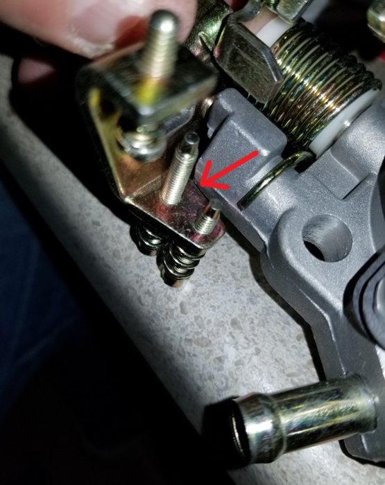

Another thing I noticed was linkage to baseplate interference when at WOT (Wide Open Throttle). As it was, the carburetor could stick in a WOT position - which is not cool!
I had to get a file out and file the baseplate down a smidge – but all works fine now.

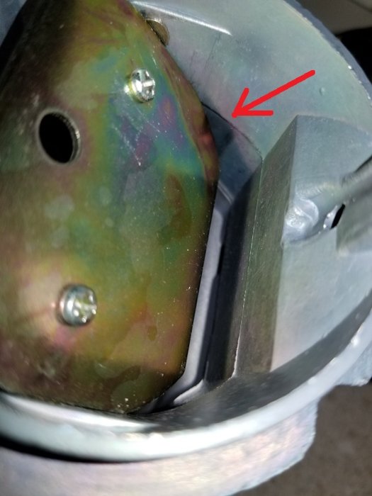

I also had to file down a casting ridge on the top, because of minor choke plate interference. Anything that keeps any moving parts from working smoothly needs to be addressed.

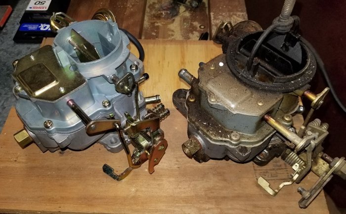

The new (Left) and old (Right) Chinese copies:
The older one has about 40k miles on it (maybe).
