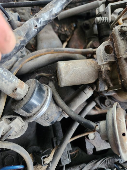

The vacuum hose is connected to the circled port on the carb, my issue is finding where it goes
Like I said you need to check the vacuum diagram and look for something that's not connected. Without anyone physically seeing the car its all a guess.
Did you check under the air cleaner? There's a connection there which is the one AHBguru mentioned.

Ok. You have the correct carb. At the end of that hose would've been a vacuum delay valve, then it would run up to the bottom of the intake, to the air temp sensor. Another hose would run from the sensor to the flapper valve on the snorkel. You could just plug it with a golf tee, and it should be just fine, or reconnect it to factory spec, if the flapper and flexible pipe to the stove off the left manifold are both good. If you plug it, it generally won't make a huge difference in how it runs, except in really cold weather.
So, I did notice that there is a nipple on that air temp sensor with no hose on it but when I hook this hose up to that it idles and runs worse, also runs worse if I just plug the hose with a screw. I'm wondering if it needs hooked up and then some fidgeting with the idle speed may correct the issue but like I said carburetors are like space age technology to me I'm a mechanic but only been in the industry for the last 10 years lol

I did and there is a nipple that this hose would reach but plugging it in makes it run worse. Just plugging the hose with a screw makes it run extremely rich to the point where it putters out and stalls
Ok. Quick cheap fix:
Plug that hose (or cap the port), not with a screw but a golf tee or something like that.
Next, you're going to get a small set of plastic vacuum tees from O'Reilly or someplace, and tee the air cleaner line into the line that serves the choke vacuum kick. You'll probably need a decent length of new hose to run from the carb to the tee, then from there to the air cleaner and choke pull-off. That would put you back to square one at factory spec. I think that should cure it.
