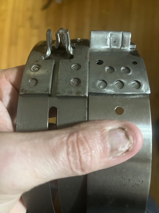

New kick down bands
Camtron
Apr 25, 2019
2,435
2,041
US
New kick down bands; one of these is a re-lined OEM factory replacement and one of these is a poorly stamped replacement that comes in most rebuild kits. Cheaply stamped detent/lug to hold the kickdown adjustment bolt in place vs the three wall/dog ear tabs and back wall to make sure it all says put under load.
Just when you think your rebuild kit has everything you need, you may find yourself ordering certain parts individually.
This also makes it pretty quick and easy to tell if your 904/999 has been rebuilt as most rebuild kits have been using these cheap stamped bands for years. This one came in my kit from, Oregon Performance Transmission.

So with that, this new band is for an A500 it’s a little wider and when paired with a 3.8 ratio servo lever will make for some solid clamping force to give some nice solid shifts in/out of second with limited wear to the band and drum.
There’s a number of different band options, lining options, springs/servo levers, ect that you can pick from from venders like CopeRacing or A&A Transmission, or whoever, that are easy enough to swap/replace and improve shifting without breaking the bank.

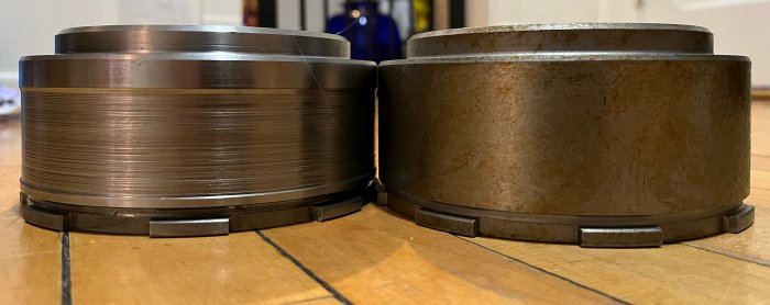

That’s the front drum out of my original trans next to its new replacement from A&A Transmission in Indiana.
Do the 904 cast drums go kaboom like the 727 drums do? When the 518 comes out it's getting a steel drum.
No! At least from my one experience so far and what I’ve seen/read online. Apparently that’s just an issue with the longer/heavier drums in the 727s. I was spinning the thing like a pissed off teenager to get it home when it started letting loose. Ate a good 1/8” + out of the drum and busted some clutch teeth but, made it home. Good way to make 4 miles seem like 400 after a day of work.
Was like a metallic crime scene.
Which, I’m sure maybe legit high RPMs from a strong, high revving race motor with high ratio servo lever and high friction band, maybe a 904 drum turns grenade but not normal failure otherwise.

Barring a previous fracture crack in the cast iron drum and "spirited driving", from my understanding, the most common cause of drum explosion is failure of the sprag and high engine rpm. The drum can end up spinning more than twice engine rpm. 6,000 rpm equals maybe 14,000 rpm of the drum, kaboom. I've seen the aftermath of drum explosions and it's not pretty. Sometimes doesn't do the driver (or passenger) any favors either.
Not really sure if it's the actual rpm the drum gets up to, or the fact that it more than doubles it's rpm in a basically in a split second that causes drum failure.
Yea, very true but it’s also still not as common for a 904 to let loose with a bang as the 727 due to the mass of the 727 drum. Then again on average you don’t see nearly as many 904s behind builds with enough torque to roll the sprag like that. So maybe it’s just the difference in the numbers of how many more 727s are being built/put behind built motors vs built 904s that get ran hard at the tracks. I’m just regurgitating what I’ve been reading lately on A body and 727 groups while I’ve been tearing mine open.

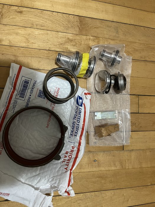

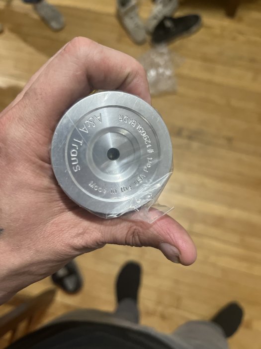

just got the last of what I needed/wanted ordered for this 999 I’m putting together. Hi performance red lined low/reverse band, billet 1 piece rear servo and spring, double seal billet accumulator, billet 4.2 ratio apply lever and front band strut and a reverse wound clutch spring for the front drum.
Now I just need to find a shop to do the stage 2 shift kit for me. There’s a slot that has to get cut into the valve body that I’d rather not hack out in the garage. I’m comfortable doing the drilling but I want the slot to be cut nice and clean and I’m fairly confident I can’t do it at home.
I’m pretty excited to get these parts in and finally get this trans together. It should shift super firm with no overlap between the gears and make for a pretty stout trans behind the 5.9mag that’s in the car; so I can give it all the damn beans all the damn time and send it around, Chicago, lol

I’ll check them out for the next 999 or 727 build I do. I used A&A, Cope, Mr. Randy (eBay seller) and Oregon performance for this one that I’ll hopefully be putting together next weekend.
When the second gear apply servo you ordered from, Cope Racing Transmission comes in…but is definitely from somewhere else, lol.
Oh well at least it’s two of the most trusted TorqueFlight vendors selling each others stuff.
Mail hasn’t looked so good in so long. Ready to get this trans together.

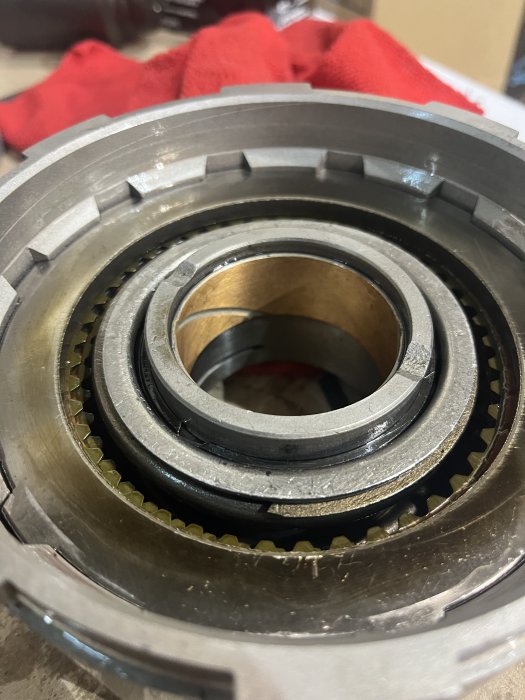

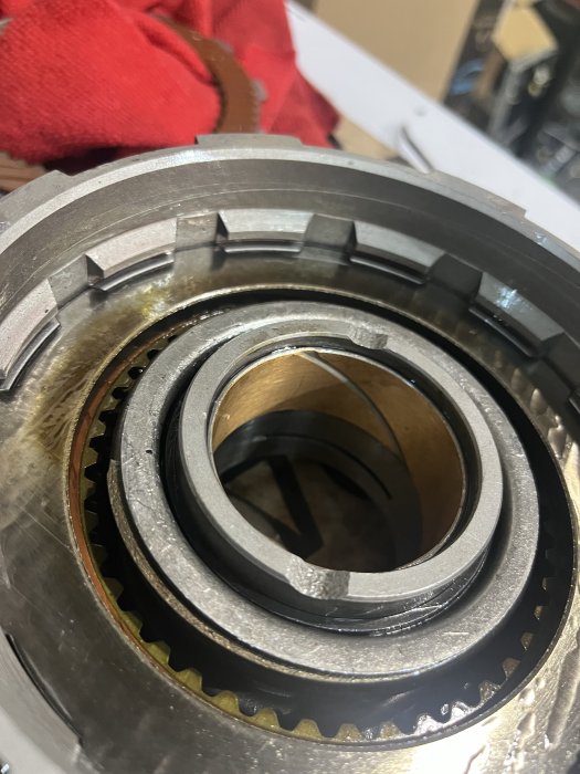

So, I finally went to assemble this 5 clutch drum, tore a lip seal had to order more shit. Just had a not great time…well I get everything on hand to assemble it again and, 5 clutches, steels and pressure plate are sitting well above the snap ring grove.
I says, the hell you do, I say. Try assembling it again, same result. Pull one steel and clutch out and BANG pressure plate drops in perfect below the snap ring groove with perfect clearance…but that ain’t right. I have/had a 5 clutch 999.
So, I call the guys at A&A, give them my clutch and steel measurements, measure off the top of the installed snap ring to top of drum and a bunch of others and they tell me “ we’ll get back to you “.
Well, three days later, they finally got back to me. They’re saying they mistakenly sent me a, rarely seen drum that’s the same dimensions of the 5 clutch drum from the 999 but the snap ring groove is relocated to only uses 4 clutches. They have only had a few of them over the years and can’t recall what the specific application they were used in.
If it isn’t just them trying to cover up sending me the wrong drum, it’s yet another great example weird little part variant Chrysler and their affiliates put out.
…but now I have to wait for another drum to ship out. Wompwompwomp
