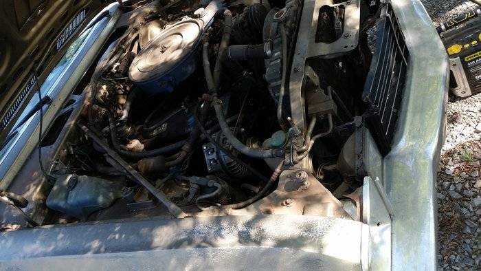

Engine started fairly easily – but I would replace starter with a mini starter to increase engine crank over speed (if car was mine).
I did not look for or to find the leak – but engine sounds exactly as if the exhaust manifold is cracked (I’ve replaced way too many /6 manifolds to know what they sound like).
The owner said engine has been going through spark plugs, pretty fast. He also said he suspects vehicle has over 100k miles on it (which I agree on). I suspect changing valve guide seals may fix the spark plug fouling condition – or if not, it will make a big dent in that problem.
Someone took off the RV2 A/C compressor and replaced with a Sanyo style aftermarket compressor – which is a bit odd. Owner said A/C works but is not cold. The car does have the factory A/C firewall bubble - which one doesn't find with Sanyo style A/C compressors, often.
Also the ordinal A/C hoses were cut and spliced, as well.

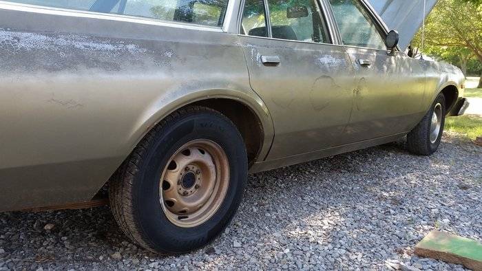

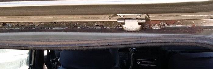

Body wise – there is rust-through on hatch roof area (see picture notes), rust pinholes on rear wheel lips and rust-through on L/F floor pan. My other under car pictures did not take – or was lost. The frame rails do have some rust, but I consider it to be minor.
No fender rust seen - even in the usual areas!

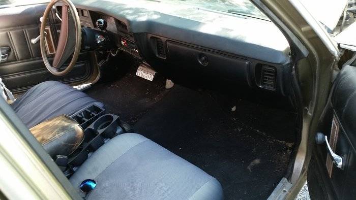

Interior wise – The dash and front seat area looks to be in great shape – if you like black, that is. The seats – not so much. The seats are intact but are in not that good of condition.

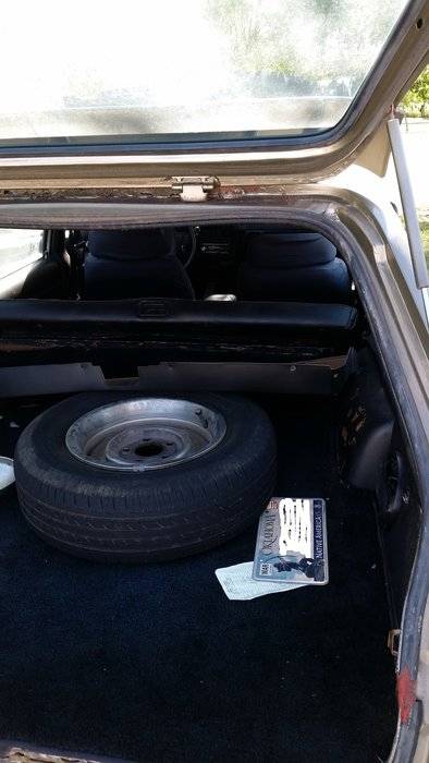

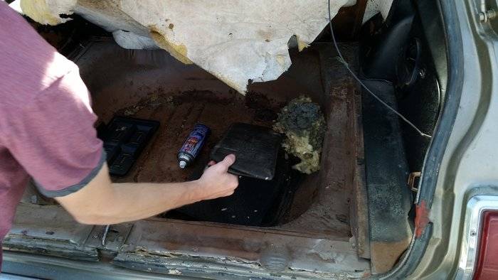

The spare tire was on top of the tray. The owner removed the tailgate trim to add speakers but decided against that and instead added speakers, recently, into the two side compartment doors. The tailgate trim was ready to reinstall – but he lost the screws for it.

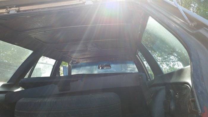

The D-Pillar trim is missing as well as the headliner.
Current owner said he was planning on purchasing carpet and gluing the carpet onto the roof!
The spare tire well is a different color than rest of car was, and I had thought maybe they forgot to paint the area – possibly. It looks like brown primer (see picture). The owner said car was painted before he bought the car – to its current color of green. The paint it sun-burnt off in several places. If someone went through the trouble to repaint the car – they did a great job doing so, for underhood area is painted the same color - but maybe not so great on how paint is sticking on.

This vehicle does need a paint job and at same time, get the minor rust spots fixed before rust takes over the car (ie: needs paint and rust fixed, sooner rather than later).

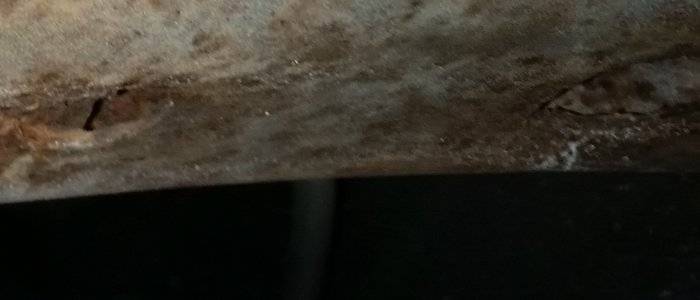

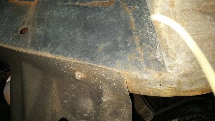

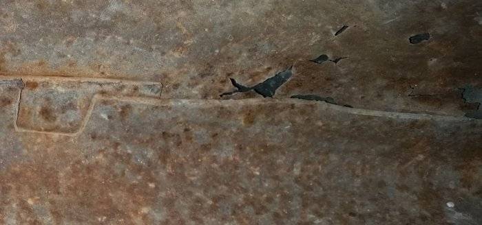

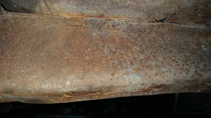

L/F frame rail, view "A"
L/F frame rail, view "B"
Rusted-through floor board, just above L/F frame rail (a blowup of above picture)
A blow-up of L/F frame rail rust (also from 2nd picture from top).
Note: R/F frame rail picture did not come out - but condition is the same (floor pan is better, there).

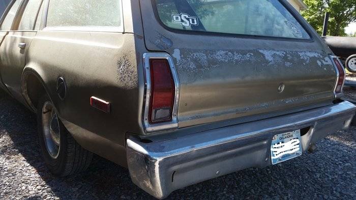

Taillamp lens is intact, but poor condition. Rear bumper plastic is broken.
I "think" the R/R wheel is the original spare wheel. The other 4 wheels match.
A blow-up of rust on R/R wheel well.

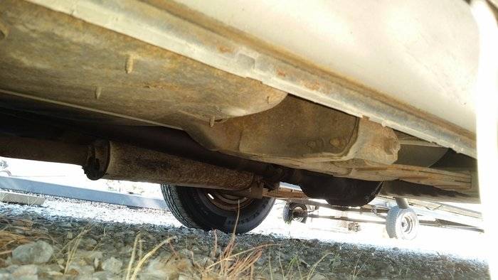

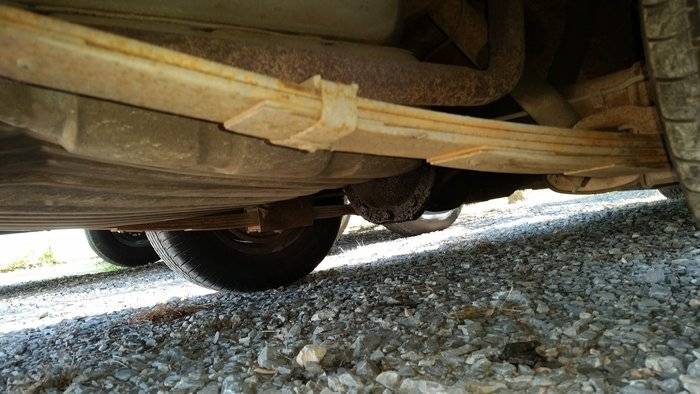

8¼” differential, with 5-leaf rear springs. The fuel tank has a small bend in it at edge of picture, from backing over something. it is not leaking.
Trunk trim panel is laying on top of tire. Car tag was just renewed March 2017. The trunk side compartment speaker can be seen with silver outline.
Upper hatch panel rust-through. Tailgate opens/closes as normal.
Note different color for spare tire area. No rust-though seen. One of the original sunvisers (which is being held by, owners hand) has a broken stand - so one will need to find one replacement sunviser.
The spare tire lid insulation is what is hanging down, in this photo.
I didn't intend on getting the sunlight like so (sorry). Lack of headliner.
Missing cowl screen. A poor shot of metal grill. You can see the factory hoses spliced. New alternator seen. Washer fluid tank is holding.
Black interior. 40/20/40 seats. Funky brake/gas petals & 8 ball shifter.
Muffler has seen better days. I'm not sure if it works - for can't hear it over the cracked exhaust manifold.

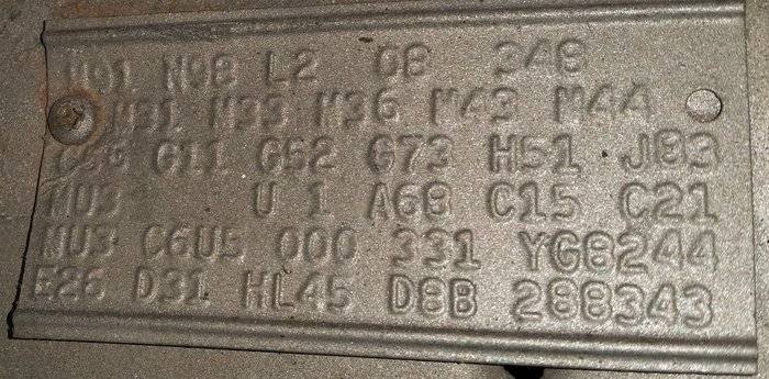

E26 – 225 2v (Super 6)
D31 – A904
C6U5 - Trim Code
331 - Built March 31, 1978
MU3 – Exterior paint is Carmel Tan (Bright Tan)
A68 – Custom Interior Package
C15 – Sound Insulation
C21 – Center arm rest
C56 – Bucket seats, non-reclining.
G11 – Tint Glass, all windows
G52 – Left mirror, Remote control, Conventional
G73 – Right mirror, Remote control, Conventional
H51 – A/C
J83 - ? (about the speedometer)
The M31, M33, M36, M43, M44 and M91 codes have to do with exterior trim and bumper trim (or lack thereof).
N98 – 49 State, with Cat Converter, wo/Lean Burn (has standard ignition).
HL45D8B2883436
Volare, Low trim level, 2 (row) seat wagon, 225 Super 6, 1978, built in Hamtramck MI
