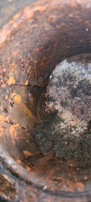

Engine wouldn't turn, so I started taking it apart and it got ugly quick. Pulled the passengers side head off and Dad immediately found a cracked cylinder wall.
Gonna wait until boss man gets back from vacation, and game plan what's next for both engine and car..as well as where I still fit into the equation.

Gonna have a chat with the boss man when he gets back. The more digging I do, the more I feel somewhat confident in a sleeve.
If it wasn't an original, numbers matching 442 I'd be less concerned and would just throw a 455 in it. With it being an original numbers matching car though, if it can be sleeved and rebuilt, that's a value saving decision.

His first question when I sent him the picture was asking if it was fixable, which my honest answer was maybe, but it'd be a bit more expensive than I was anticipating. His next response was simply to find a 455. I can't argue with that thought, but Id want to try to save the numbers first.

I “think” the block can be saved. The pistons and crank might not be. If the stuck piston is only for one cylinder, I would take block to a good machine shop to see what they say. No sense spending money on something that can't be fixed.
