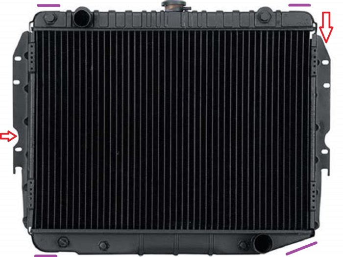

I mentioned I have a few older radiators. I also have a lot more that are "known leakers” which were saved so I can hang onto the side straps and tanks (like the original radiator from my '86 Fifth Ave).
In most cases, I can drop a 28” wide ’68 C-body 4-core radiator into my FMJ by only replacing the side straps (or having a radiator shop transfer them over) and also drilling new bolt holes 1” closer to core on both sides.
Older pickups and older C-body’s are the only ones I know of with 28” wide radiators.
I should also note core supports for almost all body types (and trucks) fall under two different classes – wide (26 and 28”) and narrow (18 through 22”).
The side straps are different for each width radiator – so you can’t get a ’18 side straps to fit onto a 20” tank without also moving (adding new) bolt holes over as well (if that makes any sense).
This picture is a typical Mopar brass radiator. The red arrows point to the metal straps which are soldered onto the radiator (in areas marked by purple lines). If you have access to a wide soldering iron or a low temp torch – a person can replace these themselves. I’ve tried, but soldering /welding is not my strong suit (so even soldering two wires together look like something a 5-year-old might do).

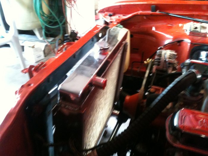

Champion CC374 is what you want. Yes, it's Chinese. I would have gone with something US, but at $600 I just could't swing it. The Champion was $200 and is a universal fit model for small blocks. The mounting ears don't quite make it all the way across, so I used a piece of flat stock on the driver's side to make up the difference.
Says it cools up to 650 horse power and I can say it's claim is true. When I had the 400 horse 360 in the car it would keep the motor at 160 degrees if I left the fans on. Like it so much when I went big block I used a 440 Source water pump housing that dumps on the passenger side. Has no problems cooling off a 600 horse 512.
For the cash, you really can't beat it. My Dad even purchased one for his S Type a year later.
