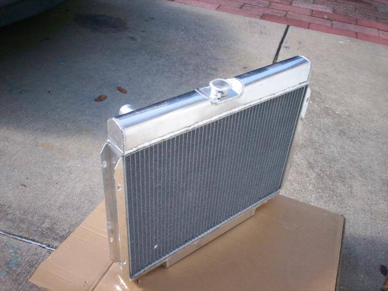

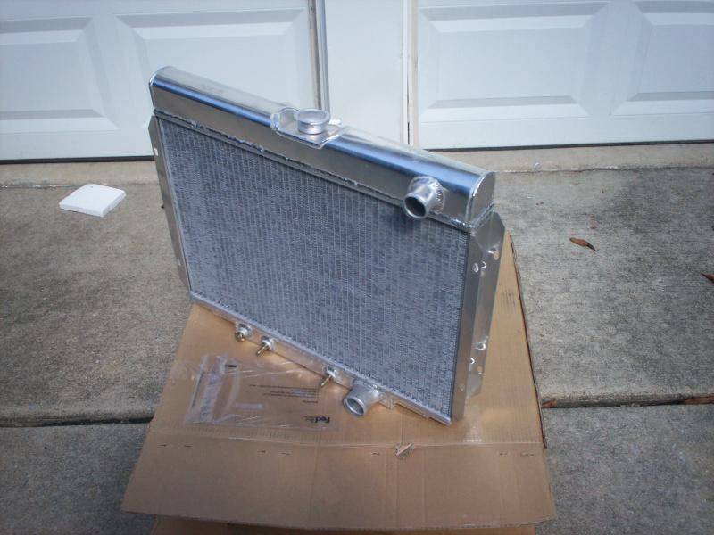

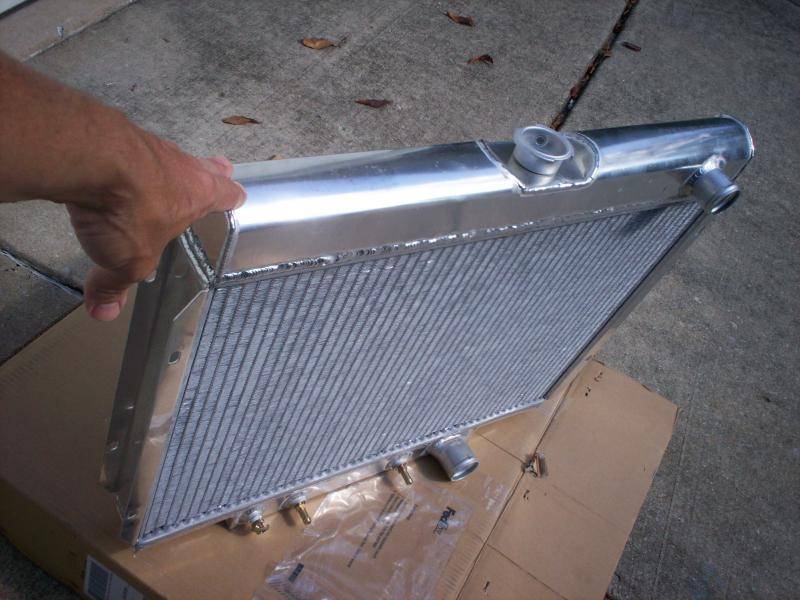

There is a local Radiator shop not far from me. Today I stopped in. These guys do industrial stuff. Brass, Copper & Aluminum. So as I still fight my overtemp issue, I asked about a 22inch radiator, since most are 26. They had in stock a 22 inch down flow with the trans cooler, center top fill cap and the overflow tube is pointed towards the passenger side. Only issue: it is top pass inlet and lower pass out let- so new rad hoses, No kidding, really! It is an aluminum 3 core that was ordered and never bought. They are asking $229 for it which seems far by comparison to some of the the online ones I've seen.
So a 3 core Aluminum for for $229? OK, it is not copper brass, but the weight difference (less with aluminum) and 3 core may be the ticket. I have to wait until next payday, so 2 weeks to think about it.
Any opinions welcome

I run a 4 core aluminum down flow in my Roadrunner, big block bored .060 over, 11.7 compression, and it runs cool, even with the AC on. $229.00 sounds like a good deal to me.

Got it $229 with tax. 1 year warranty. Just need to source an E body top hose and cut it down
