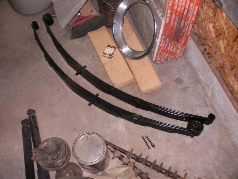

So, I called my friendly local spring shop and ordered new springs for the Imperial. They did not have the cop-spec springs readily available, but instead offered to customize a set of the 4-leaf springs for me at the same price. I agreed, and ordered them. I was very excited to get the call Wednesday afternoon that they'd arrived and been modified for my application, but my joy turned to disgust pretty quickly. Despite that shop not having them even available for several years (including the last time I ordered a set), these somehow came through with the God-awful oval front spring eye. The extra leaf is a nice, beefy full-length piece, though. Probably a little heavier than an actual cop spring, in fact, which is a good thing.
I won't say "there's $260 down the tubes" but I sort of feel that way. I may order poly bushings and push out the rubber crap to correct them somewhat, but that's an expense I didn't think I'd have to make. Then again, with the sliders out back rather than shackles, maybe it won't be that bad. I really would've much preferred the round eye, and had I known this was going to happen I would've ordered the Firm Feel E-body spring hangers and a set of E-body XHD springs from Summit for around the same money. I might just sell 'em and take that route still.
Oh, well, at least I shopped locally!

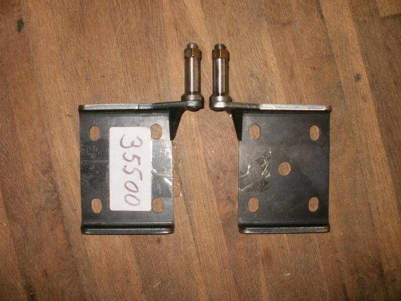

In my quest to rid myself of all things iso-clamp, I also ordered up a set of the American Muscle rear shock plates for B/E-body applications. My thinking here was I'm having a tough time getting to the boneyard this summer, and even then I'll get rusty originals that may break during disassembly. For what guys are asking for cleaned-up, pitted used ones, $105 seemed pretty easy to swallow (carshopinc.com).
These turned out to be a very pleasant surprise. Extremely well-built pieces, certainly stronger than the originals... and of course, not beat up or fatigued from 40+ years under a car! Yes, that's the part number taped to one of 'em.
