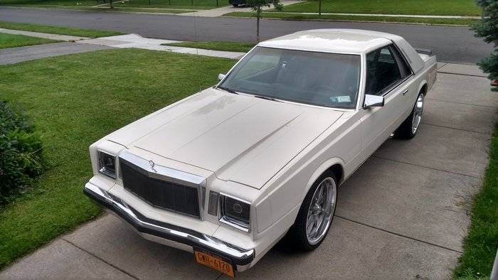

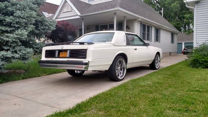

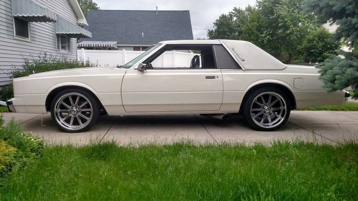

So I finally broke down and bought the rims I wanted for the doba. I was planning on going with 17's, but with a small price difference I ended up going with 20's. They are us mags 20x8" in the front and 20x8.5" in the rear. The tires I'm rolling on are zenna tires on a 245/30/20 in front and 255/35/20 in rear.
That's what I thought. The guys at the tire place we're telling me if I had went with 275's in the rear, there would've been rubbing issues. Seeing this I should've stuck with my gut and went with the wider tire.
I have 275 40 17 on all four corners, no rubbing. wheels are 17x9 5 5/8 back space. I don't think your backspace number matches actual dimmensions
I guess it depends on what is being measured. Mine is from the wheel mounting surface to the outer lip of the wheel.
Thats what I usually go by. I checked on us mags website and it says the same thing. I don't know what to tell ya lol
