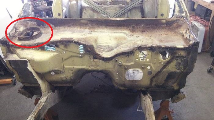

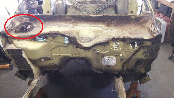

On 4-door cars/wagons, have one person with a flashlight and another person inside of car. shine the light around each door frame and other look for light bleed through - which points to a weatherstripping issue or door alignment problem. sometimes this has to be done both directions (inside out and outside in).
On non-door issues, the thing to do is get someone inside car with flashlight and someone outside with a garden hose running water here, there and yonder (not under high pressure) and leak should be at least narrowed down to general area.
My wagon leaks under very heavy rain - and the reason (I presume) is improper assembly of (or rust) the air horn above the heater case in the cowl. The rain just goes down the through the heater instead of through the cowl drain flaps.

That wagon is a no a/c car right? On mine the left air vent will also leak in heavy rain and sometimes not even that heavy if she's just parked, since your's would have a right side vent also, maybe that has something to do with the leak
1,494
The air horn is spot welded onto the firewall. Then sealant is spread around where the two pieces attach. I have looked inside of the cowl and the drains are not obstructed and no signs of rust - but can't see the air horns. Yes, the wagon is a no-A/C car - but drivers side is OK during heavy rain.
I thought about getting a borescope to verity my suspicion - but figured I'll be doing some major repairs to retrofit to A/C - I might wait until then and get it all done correctly, for there is nothing I can really do at this point.
