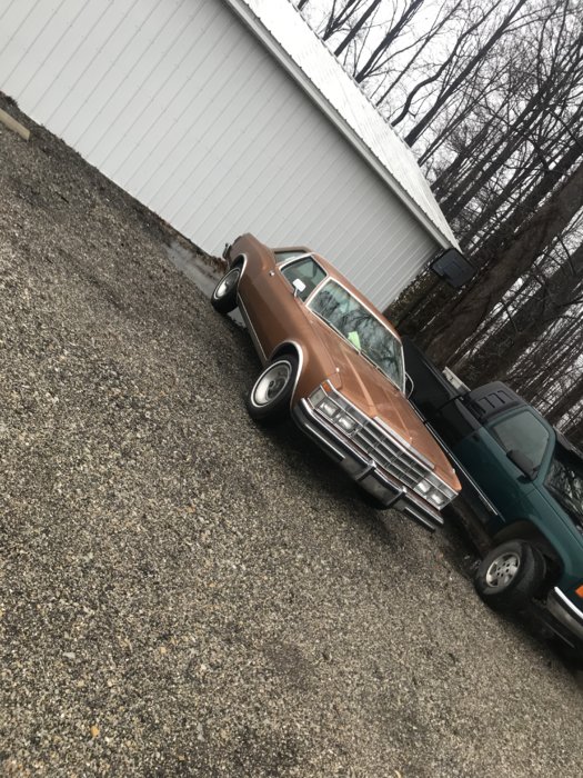

hey guys I just recently picked up this 2dr 78 LeBaron believe it’s a medallion for a steal. Being new to the m-body I have some questions that may come of newbish lol.

Is that a survivor car? Looks great.

And thanks I don’t know him any owners it’s had but has stayed original down to the lean burn system there is very little rust at all on the car I’m pleased for the purchase price lol

Before I forget, excellent looking car!

Thanks aspen! I’m hoping to make it a nice driver just have some little odds and ends to put together for it.
