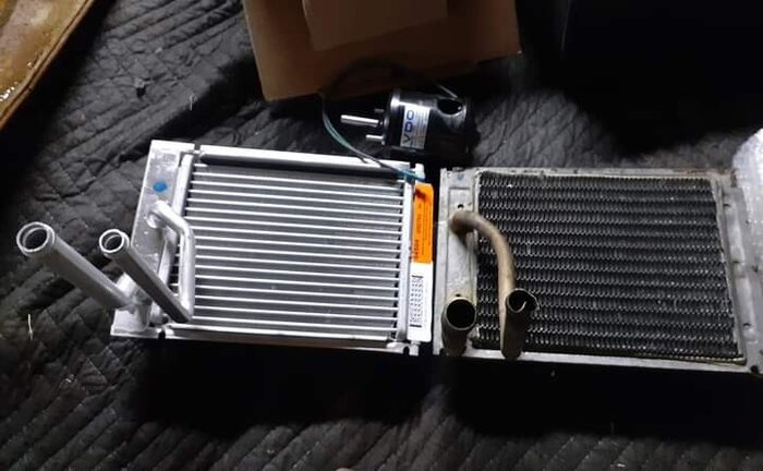

I guess a 1976 Dart non-A/C is a direct fit from what I've seen and read. IIRC the tubes might need adjusted slightly to line up.
Dart left, Aspen right.

I ordered a core for a 76 duster, it wasn't terribly expensive and if it doesn't quite fit I'll do what I have to do to make it fit, like I did with the mustang radiator... that's just what you gotta do sometimes to these old cars that have limited parts availability. I really don't want to recore it because my local radiator shop charges exorbitant fees, last time I had a radiator recored it was over $600, yikes, and having it sent off is gonna put my car inoperable for a while plus all the shipping fees, the duster core was only $37 plus shipping, hard to beat for a little extra rigging

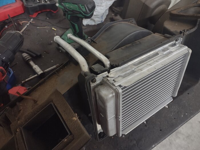

Drats, I took the dash apart and removed the old heater core, bent the pipes a little on the new one and cut the case out for them to go through and it fits in place, but the pipes don't quite stick far enough out of the firewall to get a hose on. Bending them into place must've shortened them just enough to cause a problem. I'm trying to hurry and get this finished, has anyone put an A body core in an F body before, what did you do? I'm thinking I could extend the pipes with rubber hose and connect with a splice or somehow make the heater core set farther forward in the heater box. Here's what it looks like sitting in the heater box:

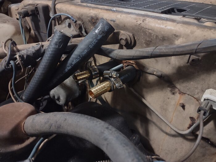

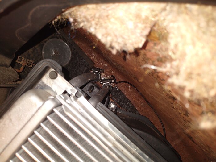

I ran short pieces of heater hose out of the firewall to take up the space and spliced them into the main heater hoses. I put the heater box and coolant back in and ran the car until the thermostat opened and got the core hot, no apparent leaks, so it appears that trick did it. Time will tell if it lasts though. I probably have the most jury rigged cooling system on an F body now with the mustang radiator and duster heater, but it's cheap and necessary when you can't get the right parts...

Those hoses need some kind of grommet between them and the firewall. That'll wear through in short order.
first thought was to drill the firewalll holes bigger and clamp the hoses inside, then put some dum dum or sealer at the firewall, then put a fake retangular plate at the hoses and put a screw in the plate. some of the non cars have that plate, then add some loose clamps for appearance only for a factory look. nobody would ever know
