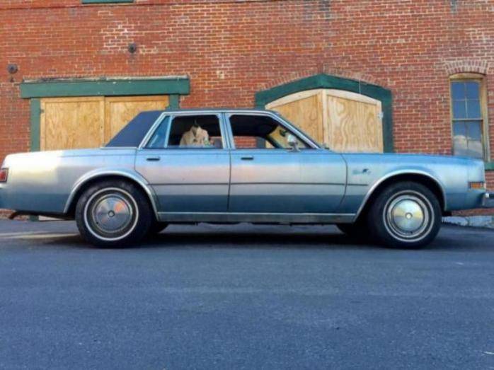

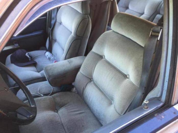

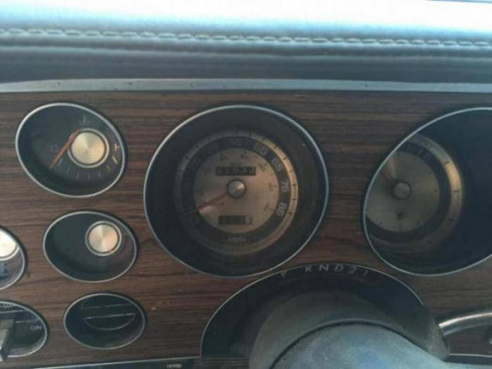

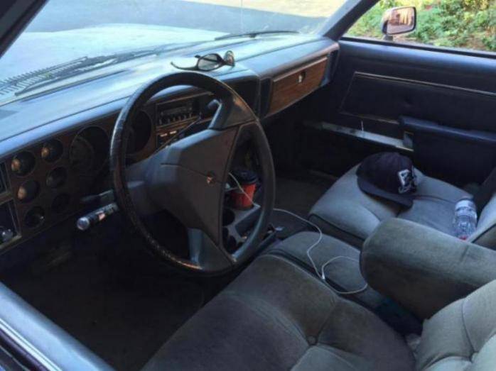

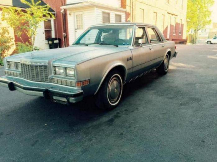

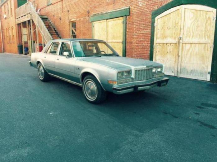

Thanks for letting me join the forum! Just picked up an 88 Plymouth Gran Fury that's fully loaded. Looks like it only has 81 k on the ODO according to the title and runs very well. It does have the LB cpu and have already checked into some HEI swaps. Any info anyone could pass along, I'm all ears. My parents and I spent a good hour or so vacuuming out the interior due to a pine needle infestation and my daughter and I cleaned up the outside
