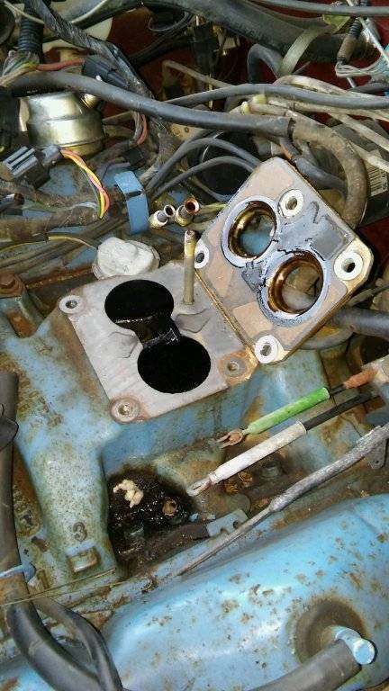

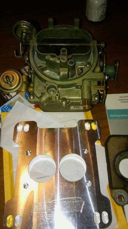

Umm, again, not looking to tangle, but this isn't like any 318 carb intake I've ever seen. There's no choke well for the carb. In fact, the EGR is on the passenger side where the choke well normally is. It shows sharp machined edges at the throat, resembling the later TBI intakes, but the bolt pattern is different. One bolt is offset, and it's larger than the 318 BBD carb base. I'm making an adapter to use a larger 2V carb so as to not drill the intake, nor change it. The P.O. set it on fire and damage the EFI harness and fuel control boar, so I am going carb. Will post pics soon.

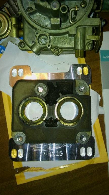

So basically I used the base plate gasket as a template for the bolt pattern to secure the adapter to the manifold, and the holes are already there for the carb. Snug fit with that particular carb, which is what Mopar used on 360-400's. That way I don't drill any holes in the manifold, don't have to change the manifold (at this point), and have more carb, but not 4V size.
ya, that's unique to the EFI for sure. See? I need to buy one to know what I'm talking about! I have an eye on a certain green EFI Imp that someday shall be mine maybe.
That must be the TB spacer gasket that is a must change thing in the last pic. A carb makes them a real car. :)
Sounds like good enough reason to me. :) The fellow who had this one was all about getting the EFI fixed, and I get that, but I'm not concerned with car shows. Maybe later, so I'm open to restoring the EFI, but right now it's better to have it drivable.

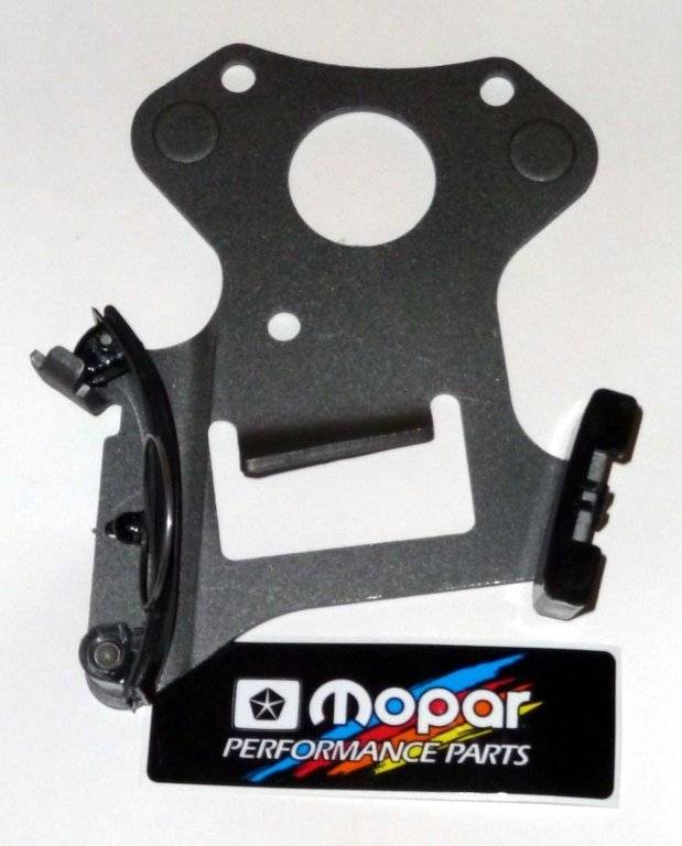

I recommend for ANYONE building a Chrysler small block or changing the timing chain on one, to install the timing chain tensioner setup and you can thank me later for it.
Now to find a setup like that for a big block . . .
now there ya go. Those EFI Imps are timing sensitive, especially. A tensioner would keep the slop out. The nylon coated sets were planned obsolescence. Engines were thought to be toast after 100k and all parts are engineered down to that amount of life expectancy. I got 126k out of my 72 Newport before it let loose.
That tensioner is the boss. Put one in my '96 Dakota when replacing the chain and no more idle rattle. It rattled at 49,000 miles when I bought the truck and rattled at 150,000, only worse. Couldn't take the noise anymore. The 3.9L engines were notorious for chain rattle, right from new. That's why they added the tensioner in '97 but it retrofits into any 3.9/5.2/5.9L and of course, 318, 340 and 360 back to the begining of time. Probably would fit a 273 also. Not sure about the poly 318 though.

Recently received a new double roller set. Will install soon as I get over a freakish episode where I developed DVT's in both legs simultaneously (I never do anything half-way). Anyway, after over a month being sidelined, my hands are as clean as they were at birth. Looking forward to getting back into things, but I am not adding the tensioner. The chain Mopar used with that tensioner is more civil (factory steel for MPI, chain link edges are smooth), meaning, if I use one with this set, it'll chew that sucker up in no time.
