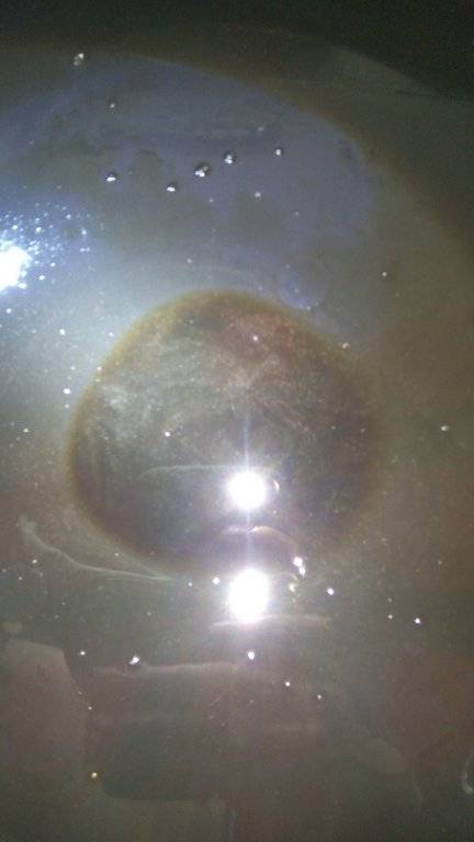

Metal found in my oil pump. Pulled the switch and piston. This came out. Thoughts???

Well me and the son (Red_Baron) looked at this again together.
I dont think *I* see metal....some very very fine particulates maybe? Dont seem to be magnetic.
We pulled the relief valve and used crocus cloth on it.....used a bore scope to peak at the hole a bit.....tough to see but to me it looks fine in there......
