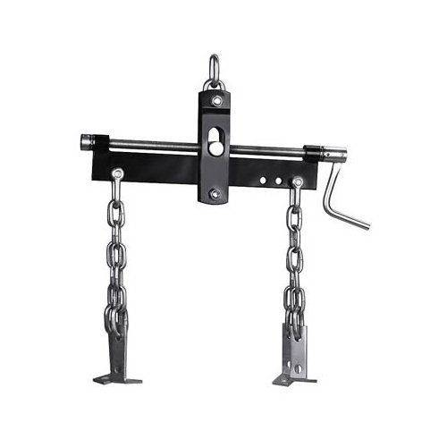

IIRC,,,,,,,,,,there's a pair of thread holes (3/8-16?) on top of the head, on the manifold side, right next to the valve cover. If you don't have an engine tilter, bolt a chain to both holes and hook the hoist onto the chain. You'll have to experiment with where to hook on the chain to get the front/rear balance right (the engine tilt).
If you don't know already, this is one version of an engine tilter.

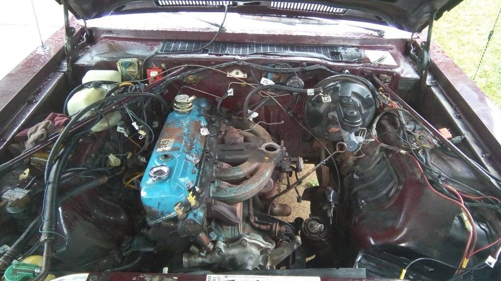

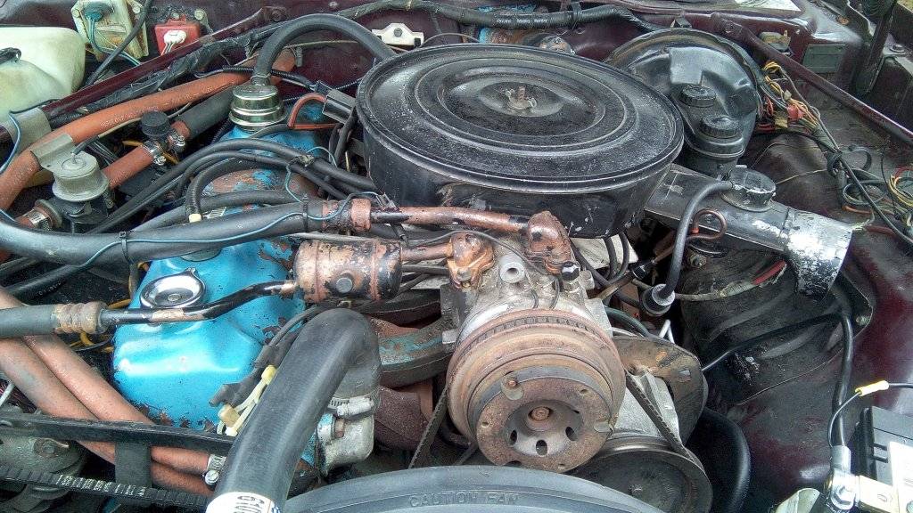

Majority of work done today. A/C is out, pulleys, wires connecting block to car, starter, emissions stuff, care, rad. New to disconnect trans lines, flex plate, etc. All done in the rain under a tent. About 6 hours in total so far. 6 hours on a /6. The irony....
Before
After
thanks to shadango for helping. And yes, we did label all hoses and wires. Made it up to 20 something, leaving most connected together. Good start. Starting school soon, so it won't be running for a while unfortunately. Sucks, but what you gonna do, right?
Yeah, we are borrowing a cherry picker and a tilter...got it last night.
I still cant get over that those two bolts are gonna be adequate to lift 400 lbs without breaking, etc. without a lift plate, which we do not have.
But plenty of folks seem to have done it so......guess we will try it.
