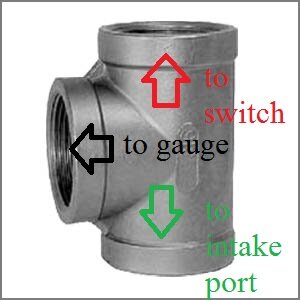

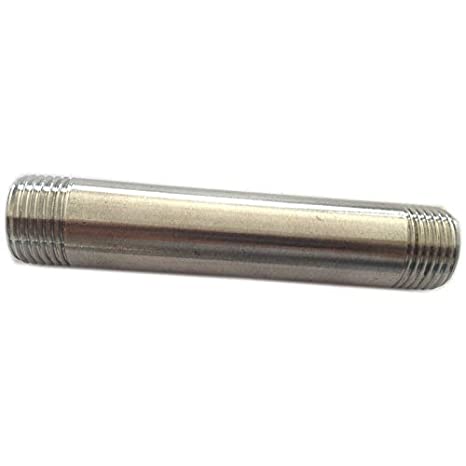

You might want to use the factory style T. It's a single hexagonal piece with the two threaded holes so you can get a socket or normal wrench on it. Also aftermarket ones around like attached pic. Easier then using pipe wrench or vice grip back there.

I second that suggestion. It'd look a lot cleaner also.

Would look a helluva lot better, 5th. Might end up going with that.

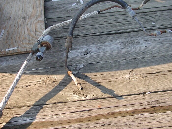

Cars with the oil cooler (police), the oil pressure sender and oil pressure switch are on the passenger side fender well. There, Chrysler uses brass fittings in the shape of an "H":

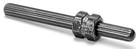

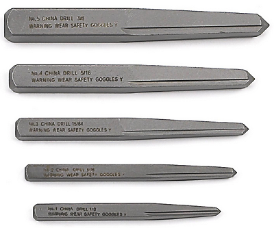

If your "T" is cracked, take care on removing it. If it breaks off - it is a "not so fun" job to extract the broken part. It is doable, but not fun.
The factory "T" is a sturdy part and the only time I see any problems is when it is left in the engine when engine is removed (for it hits the firewall) or during engine transport.
If you are working on a broken "T", you have to be mindful of not getting metal shavings inside of the engine - which is something most "easy outs" are known to do.
These two designs I find produce the fewest amount of metal shavings (if any) - but both methods need to be hammered into the broken off part:
Then the harder part is to remove the extracted broken piece from you "easy out". . .

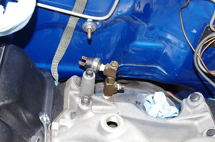

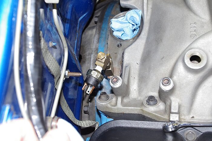

I used a combination of a brass T to do a factory gauge install and provide a feed for my mechanical oil pressure gauge. Easy to piece together, applied teflon tape and like BudW stated, watch that you do not get any of the tape into the fitting/port.
EDIT
I added a couple of pics of my install. I am still not all that happy about it (given the multiple pieces I used), but I needed the extra height to clear the manifold casting and for the factory oil-pressure gauge to clear the valve covers themselves.
