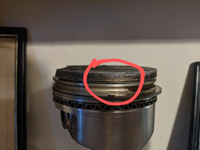

What's going on , on the top of this piston?
Sorta looks like evidence of detonation.......

Chinese intake seemed to have 85* flange angle, got a deal on a new Edelbrock 7577 and it was 87* using the same method. Installed the new intake, STILL burning oil. Still only after it's up to temp at idle, nothing on initial startup so I don't think it's valve seals. It's worse with the pcv unplugged, and with the pcv and breather plugged, it's slowly building crankcase pressure, so no vacuum leak. No excessive blow-by so I don't think it's headgaskets.
Oil is still visible on top of multiple pistons. Did a dry/wet compression test. Three cylinders were low dry- 170, 180, 190. The rest were 205-210. Adding oil brought everything to 210. So rings seen to be the last choice.
The engine ran great up until the day it started smoking.... Kb107's, fresh hone, new moly rings. Top compression rings were gapped to .032", second were 0.020" oil control rings were checked and within recommended spec.
Any ideas on what could cause ring damage so suddenly? Detonation, pinching the top ring and scoring cylinder? I haven't verified this yet, but it seems to me to be a ring problem, there's not much left to check other than pulling it apart.

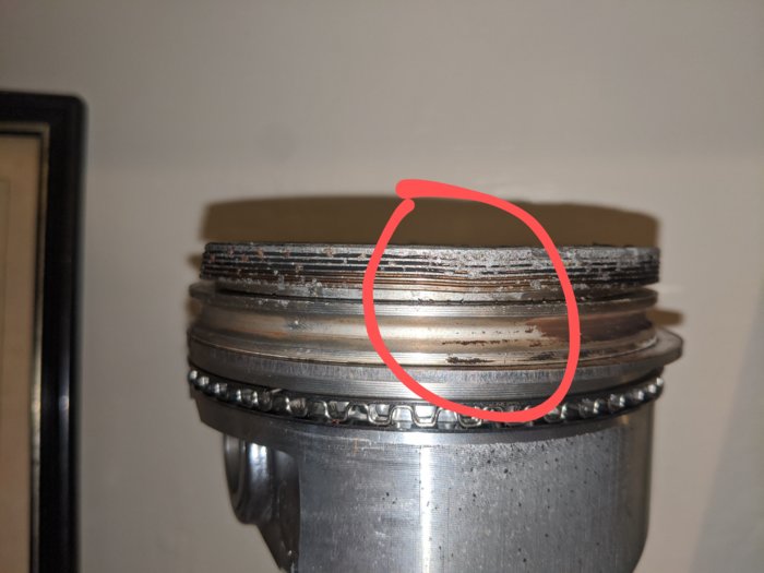

Something like this:
Does that make sense as to how rings would possible damage and cause smoking so suddenly?
1,666
Damn man, this sucks. I know those KYB pistons have their own ring gap specs and it looks like you've got that per their spec. Moly rings require a special type of honing process or they won't seat properly. Other than, check the carb? Is it washing the rings out with fuel?
