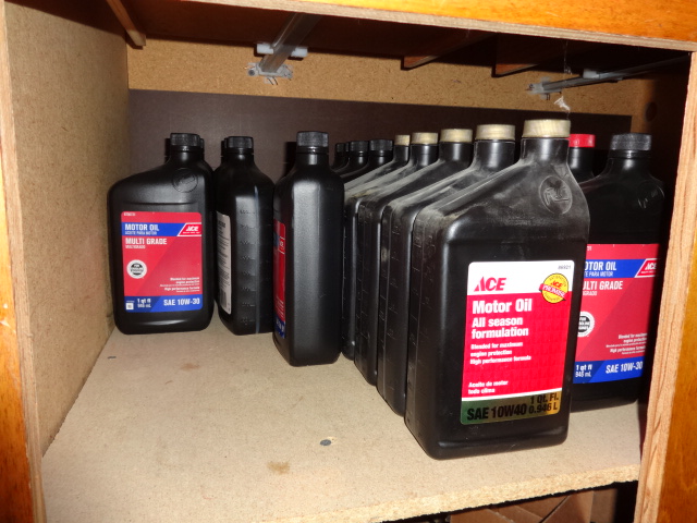

I try to never pay more then $2 a quart for regular oil on a stock motor. Just change every 3k miles. I do put a hint of additive in my truck oil because it gets used hard.
Ace Hardware oil is bottled by Chevron
Harvest King is bottled by Citgo
Look for deals in 5 gallon jugs, name brand still $2 a qt in the end.
Im always stocked up about 2 years ahead. You local ace hardware clears stock out every fall $2 a qt.
