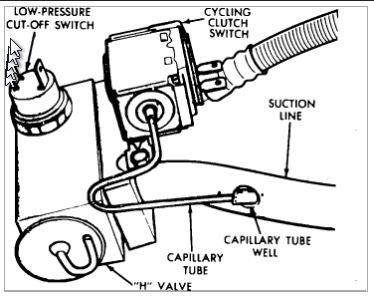

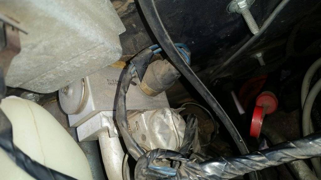

Without being there – I don’t know for sure, but I suspect one of two issues (or both).
1. Engine is overheating and Lean Burn computer is preventing A/C compressor operation (or something else along those lines).
2. The Evaporator core is freezing up stopping air flow through it. After car is turned off, it melts and is good to go again. That would be affected by the A/C clutch cycling switch or in that general area.

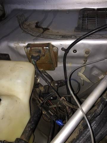

Can you take a picture of this area please, and post here?
This would be in the Right Rear corner of the engine compartment, by the washer fluid bottle.
