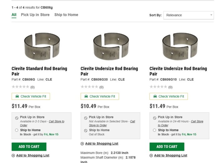

What I usually do is go to your favorite auto parts website and insert the part number (only). My favorite one is https://www.oreillyauto.com/ . Then type in a part number (like CB606G, for example).
In this case I came to this:

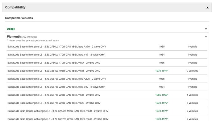

From there, I scroll down to Compatibility:
It appears this part is for a Chrysler only (but I didn’t go any further than that).
A lot of manufactures share the same part number. In some cases, one company might make a part and place in other company's boxes.

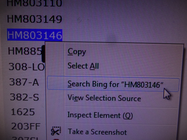

I simply right click, it turns blue and it says search bing and poof every part came up.
Pretty simple to do ones own legwork.
