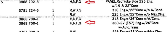

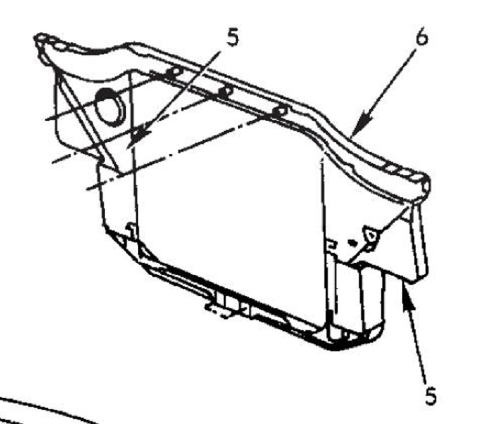

    My wagon will be converted to A/C (one of these days) and part of that process is to convert my existing 18” radiator to a 26” one.
    To do it correct, it requires replacement of the two metal plates (painted body color) located on both sides of the radiator that is welded onto the core support.
    Item # 5
    To clarify, H & N are F-body and F & G are M-body.
    R, W, X & S is B-body, so not applicable here.

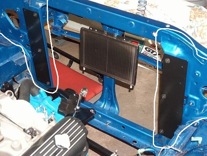

    There is a couple of other ways to accomplish what I want to do.
    One version is to get out the Sawzall and start cutting away, then drill new bolt holes.
    Another version is what another fellow forum member did. He made adaptor brackets which he attached his wider radiator too. This method works as well – but the entire width of radiator is not used.
    You can see the plates outlined in white, here. His hand-made brackets for radiator are black in color.

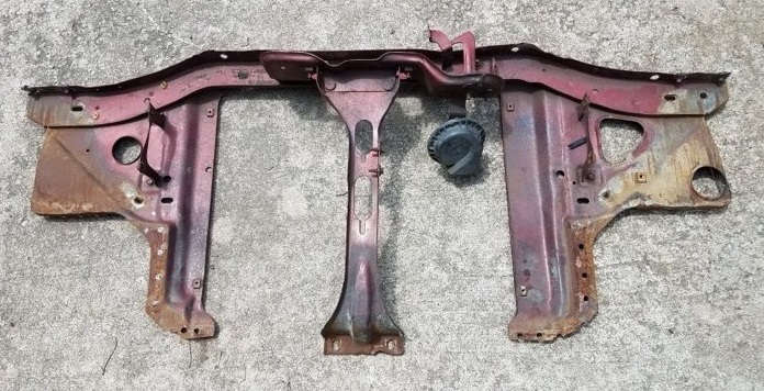

    I did remove the radiator support at the spot welds if you are interested in it.
    I did remove the radiator support from my RT but don't need it as my other car already has a 26" opening if you are interested in it.
    Exactly what I’m looking for.
    Actually, I don’t need the top part – but it is easier to remove and reinstall with it still attached.
    On the picture, above. The two grill brackets, the center upright and the horizontal plate is not needed, and they can be unbolted to make the item more flat and easier to ship.
    I do recommend you keep the horn. They do go out from time to time and are getting harder to find.
