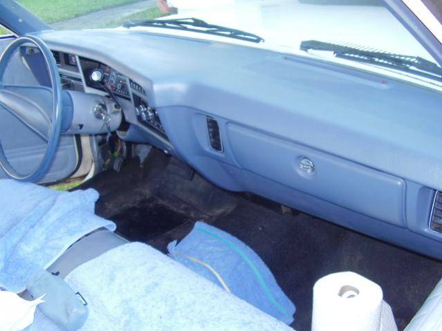

Here's my cap painted and installed. I have since repainted the column too. Sun had taken it's toll on everything.

That looks really nice LSM360. Thanks for sharing. Yeah some women are funny with money sometimes. Its like they are scared they wont have money for what they want. And boy do some of them have a huge want list. What we do for love. Beats being alone. I like to eat she is a good cook Lol.
