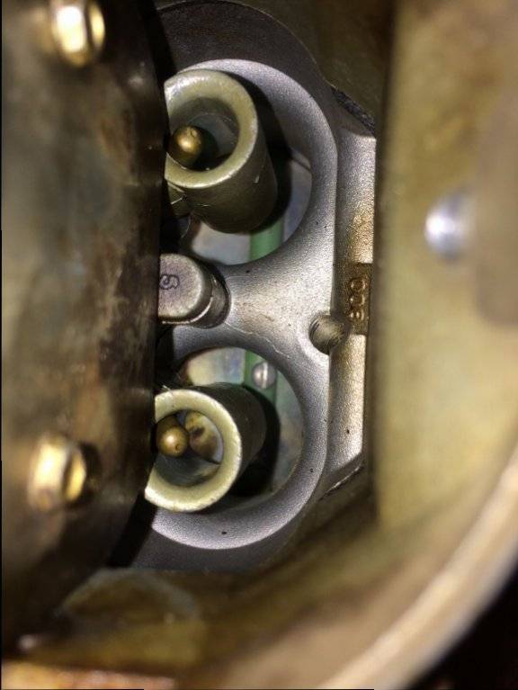

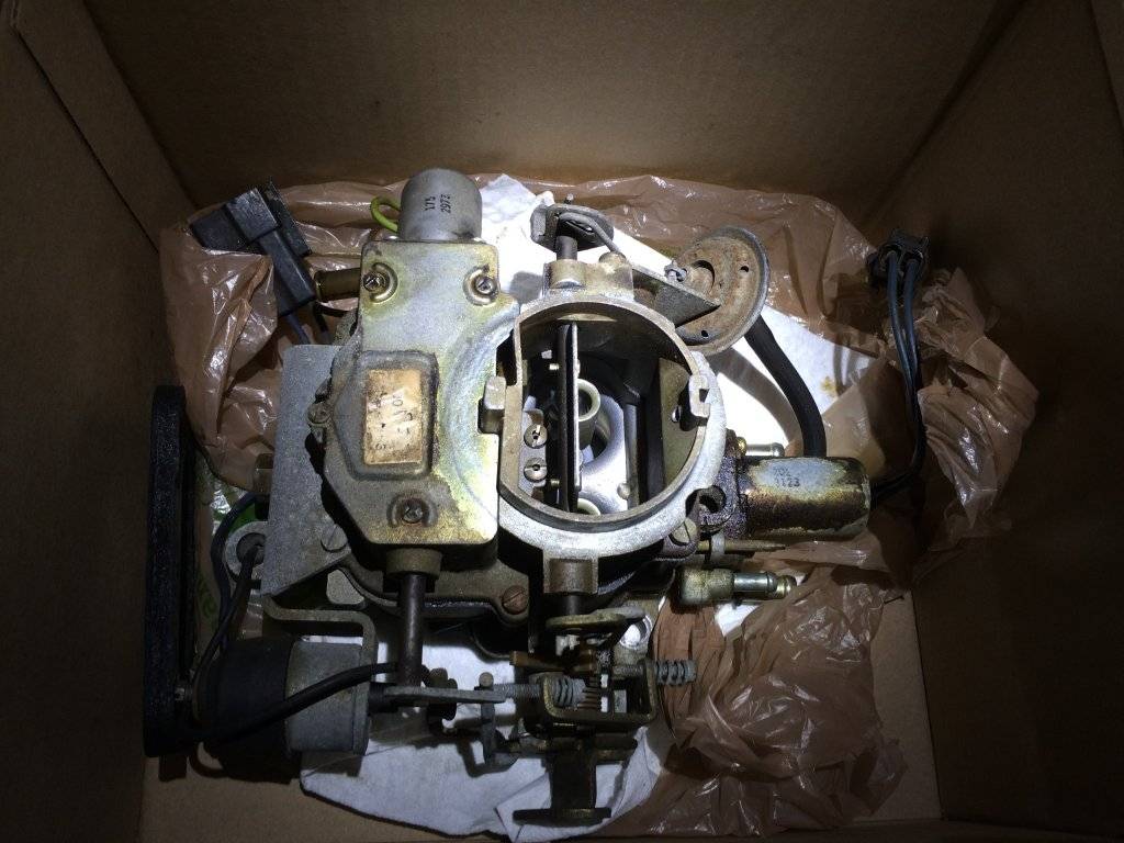

Alright y'all, here's what happened:
New MSD ready to run distributor installed, and a re-manufactured carter 2bbl that was supposed to be on a Cordoba. (no electrical connectors) The install went really smoothly, timing set properly, and the carb bolted right on. My idle has smoothed out an insane amount, and I don't have to wait forever for my car to warm up before it's running good. Doesn't stumble any more, and just generally runs much better.
Now to the pinging: The carb and dist. did help quite a bit, but there was still a slight ping. I put premium gas in it, and pretty soon after the ping started to go away. I bought a can of seafoam and added it into the gas, figured it would be less violent that way. Nevertheless, things are doing a lot better than they were before.
And for the fun stuff, pictures! no wonder it wasn't running right, these parts are crusty!
