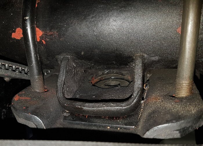

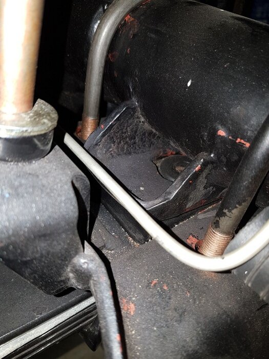

Hmm, I'm sure these will do, although that's not what I ended up working with.
I picked up the WFO 6.0 deg shim (just search for 'wfo 6.0' and you'll get plenty of hits). These are just straight rectangular metal pieces, with a 6 deg slop from one end to the next.
Now the reason why I picked these up was so that I could shape them to fit the ISO bracket setup. Took a little elbow grease but I simply manually shaved a little metal off the sides until I had a fit between the shim and the top ISO plate, sort of a "fit" if you will.
Once that was done it was just a matter of tossing them in and re-bolting everything together.
One point to note: if you have the large spring/ISO pad locating ridge, clearance the shims for that first before you start shaving off the sides, you need an anchor and that's the perfect spot.
I've attached a few pics that show the install. When I did these I had some detailed photos, but I think I lost these when my garage phone took a little "off time" (LOL, but grrhhh).
In these pics, the shim is actually that metal piece sandwiched between the axle perch and the ISO top plate.
