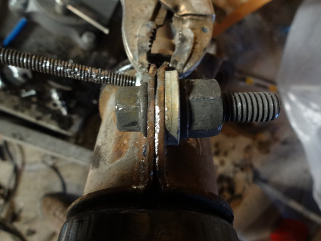

Not sure how others do it but if ya notice on the clam shell prior to starting there is that spot weld on each side of the attachment bolt. Many will cut or chisel that spot but I drill it and when assembling I use a threaded rod and washers/nuts to draw it tight then tack the outer edge then release and fill/weld the holes I drilled the spot welds out at. Then the shell is attached to itself from end to end.
Its never a pretty process till the end but lucky for us the shells can be worked and made to look sad but are easy to get back into shape.
