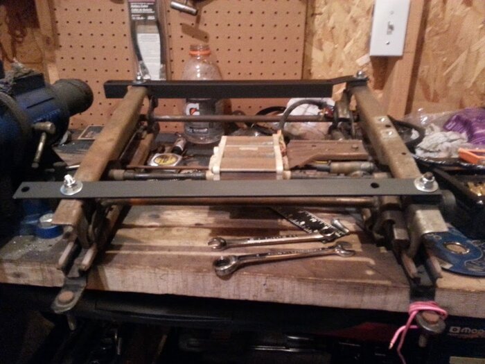

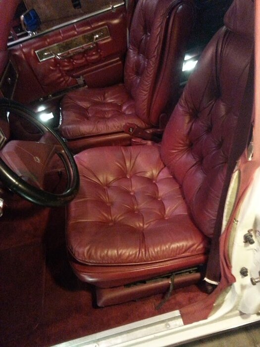

If you wanted buckets that match the interior you could always mount a passenger seat to your driver's track. I found another red leather 5th at a pick 'n pull years ago and did just that. You need to move the seat over a couple inches to the inside to clear the B pillar. Did it with angle iron.

Charger or challenger seats shouldn't be too hard. They bolt in instead of studs like these cars and the tracks are flat so you could easily use the right size square tubing to bolt into an M to get the height then thread holes in the tubing in the right spots to bolt the new seats to.

Looks like I need to find an Imperial seat and transfer mine to it. It has to be from a 2 dr.
