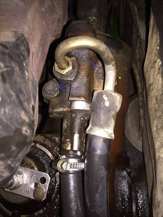

So I got the fluid changed to proper PS fluid. It made a difference right away since I can now easily turn the wheel left at idle, but it needs a bit of force to turn right.
So I guess this is the time to try and adjust it with the two screws on top of the steering box as Aspen 500 mentioned. I have a picture of the box - Is it the two arrowed screws I need to loosen to do this ?
7,323
2,971
Yes, those are the ones. As I mentioned, only loosen them enough so light taps with a hammer can move it but not so loose the seals start leaking.
This adjustment is mainly for "self steer" but can also affect turning effort. If it's still stiff to the right, then it's a seal leaking internally inside the steering gear. Hopefully, it's just the valve adjustment!

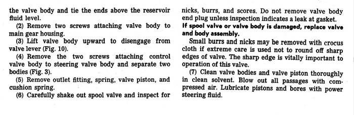

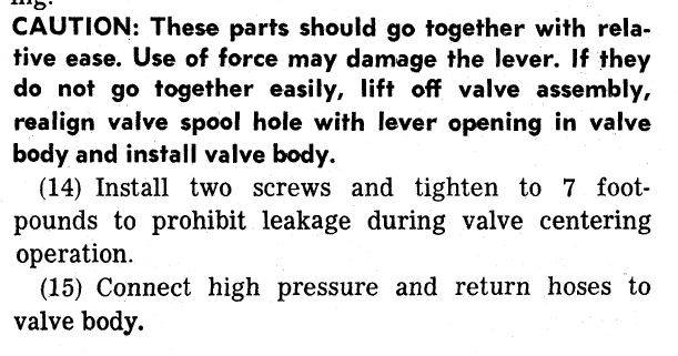

1,492

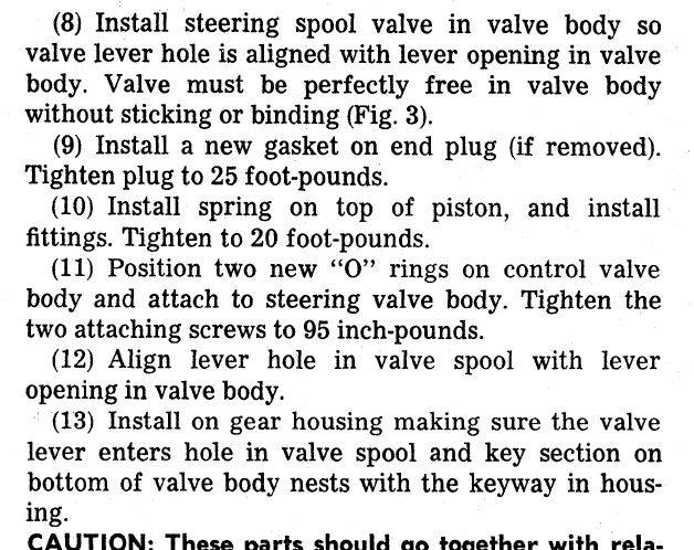

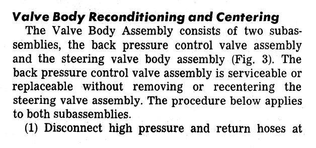

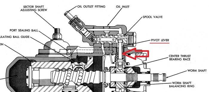

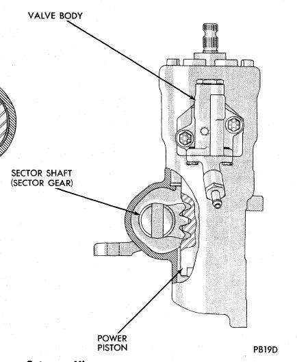

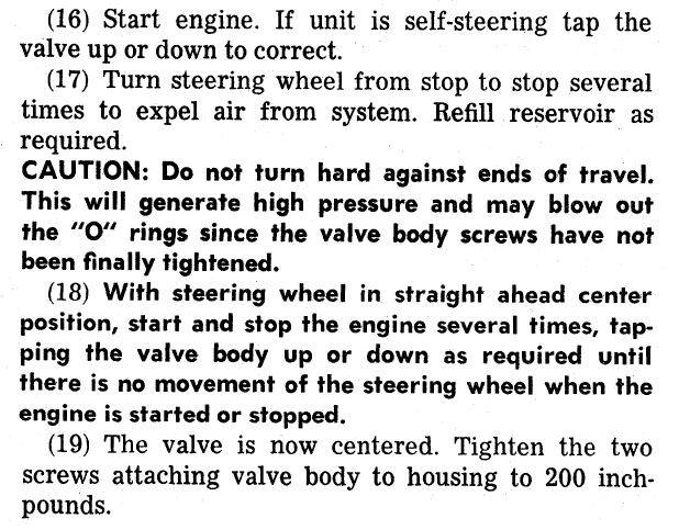

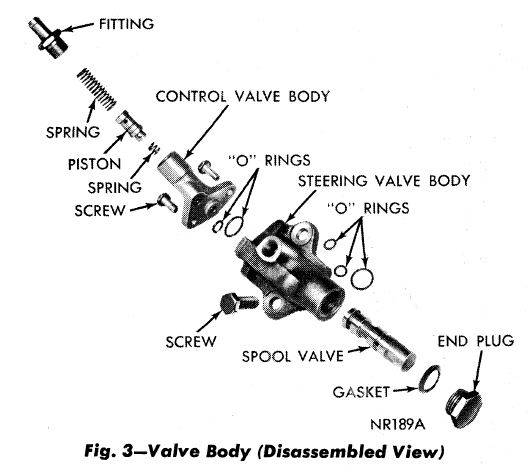

I thought about freehand drawing a picture, or two, on how and why that valve needs to be adjusted – but decided to look online instead. I do remember Rick Ehrenberg doing a detailed explanation on this a few years back, for Mopar Action Magazine (now out of business).
He has the article but it’s not available online, yet.
This information is from my ’77 FSM talking about adjustment. Mote: it actually talks about valve removal, overhauled, reinstalled then adjusted – so two thirds doesn’t apply. I went ahead and copied it anyway.
The part that needs to be re-centered is this rod – called the pivot lever (red arrow in picture). It senses the steering gear being turned and applies hydrolytic assist to turn car. That rod is “thinking” car is already in a turn and is applying the variable P/S assist already.
Once it is re-centered, all should be back to normal, again.
