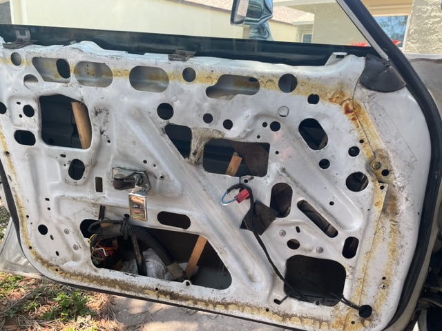

The power windows in my Diplomat were all toast. One was held up with a bolt tapped through the track/guide. Another with a block of wood. Seeing as I'd have to remove the regulators to change the motors anyways, the price of window motors, and that not all of the switches worked I decided to convert the car to manual windows.

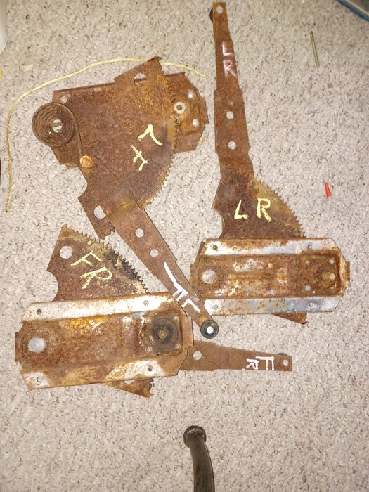

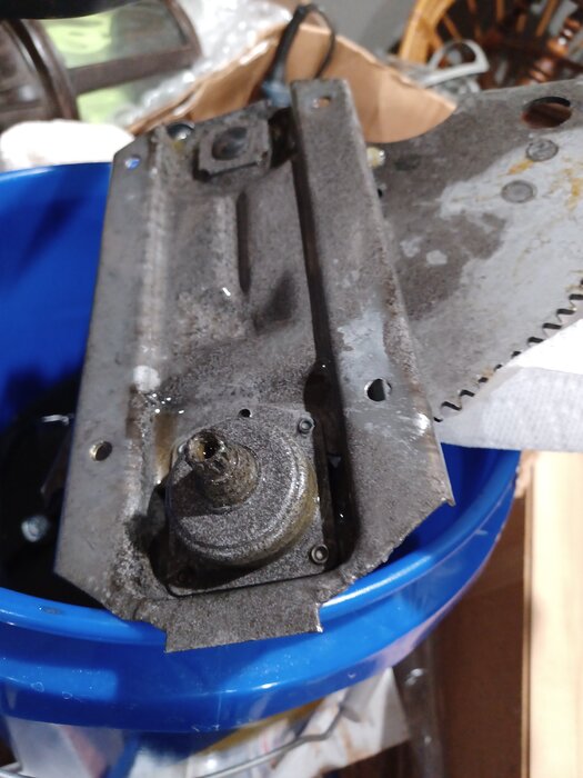

I got the regulators for $20 apiece from a junkyard and soaked them in evaporust 20230125_182654.jpg

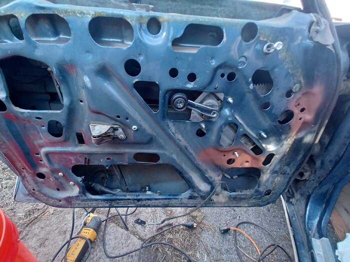

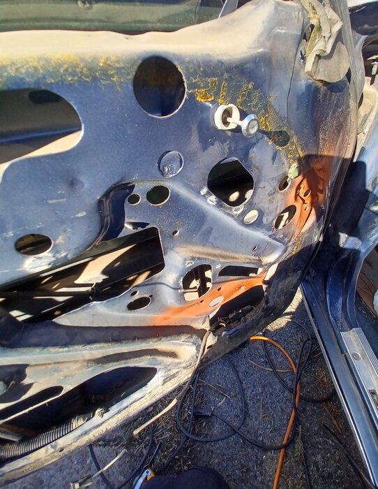

Used an oscillating saw to cut the rivets on the power regulator. The window I held up with zip ties so it wouldn't drop when the rivets were cut. The service manual recommends lowering the window slightly. This makes it easier but I managed to do the passenger side with the window stuck.
I rerouted the mirror control and painted where I scratched it up. I was surprised to find the hole for the mirror adjuster in the correct spot.
Then I installed the manual regulator which is rotated counter clockwise from where the power regulator goes. All the holes were already there. 20230214_152818.jpg

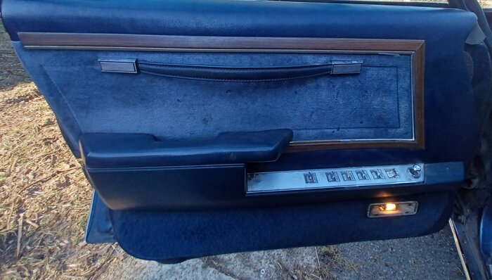

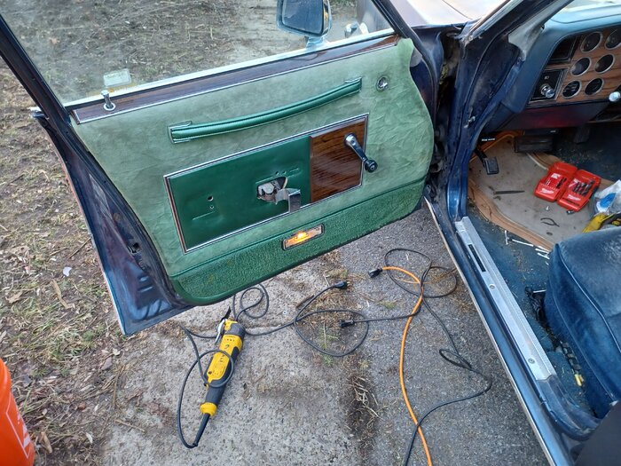

Then slapped on the new to me door card

FYI or for anyone else reading you could have also used the old door panels, the panel that the window buttons are on also comes as a blank or power locks only and the back of the door panel is usually marked or pre cut where the crank goes.
Looks like evaporust did a good job. Its surprising how bad that looked compared to the door panels.
Yup, there's a knock out on the existing panels. I'm using these cards because they came with the seats that I'll eventually put in.
There was no way I was putting rusty metal in these doors. The car is rust free and I don't want that rust belt cancer to ruin this car. Reasonably priced, rust free, no emissions test cars are hard to come by up here.

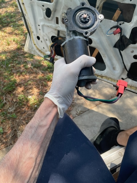

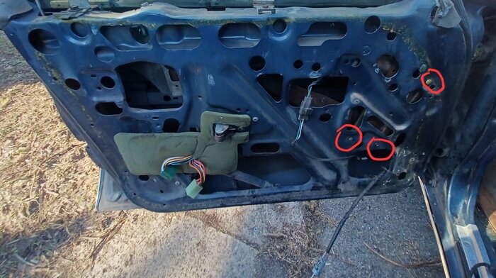

Three bolts holding motor are easy to get to. Motor basically drops once those bolts are removed. Putting a motor back in requires jamming arm up there and results in a lot of scratches but I've never removed regulators for that job. But you said you are just removing motors and doing away with them so unbolt the three bolts and it'll drop out. I have a motor out right now, regulator in place, window propped with sticks. It's not really hand size it's more forearm size but again, that's for installing which you aren't doing. I've pulled dozens of motors, both for parts and repair. I'm 5'11" 150lbs FWIW
Motor is easy (6'2, 200). Just lately pulled one, disassembled,repaired and reinstalled it. Fairly easy.
