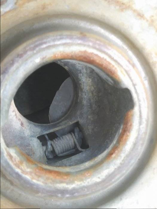

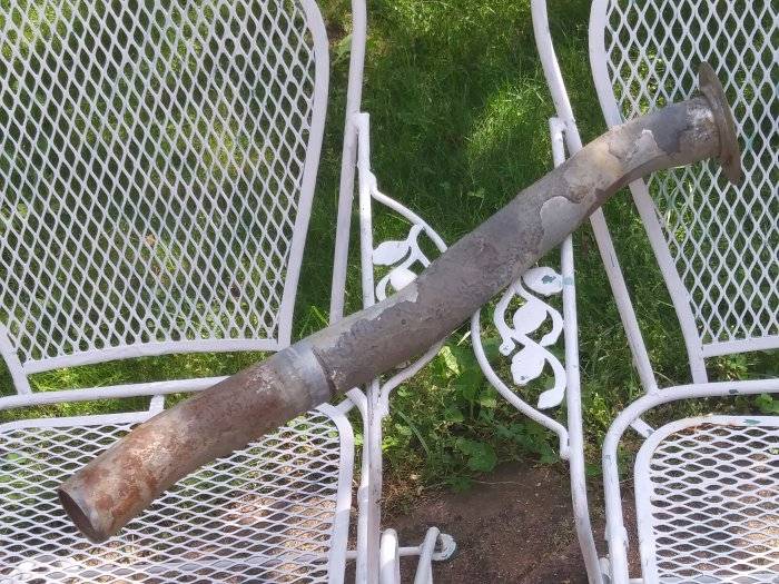

I have the "hump" gas tank and the filler neck is almost completely horizontal. Any of you have the problem of gas backing up in it? My car constantly leaks out the filler port when trying to fill up. I did pull the filler neck one time, to replace the grommet on the tank. It was pretty clear straight through, aside from some white surface corrosion at the end. This drives me crazy. I have to hold the pump at a funny angle and let the fuel trickle in slowly. It usually still leaks a lil bit.

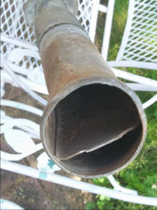

When I pulled my 79's tank, it had a center divider tongue that was bent a corroded. Now, here is the 77 coupe. Note the metal tongue is perfect.
I pulled the tongue out of the 79 filler neck and the problem was lessened, but still fill it slowly.

Mine has that tongue too. It has white corrosion all over it. Was thinking of soaking it in muriatic acid.

I wonder what the purpose of the tongue was?
IDK. I suspect as an anti-siphoning mechanism?
All it does is give grief.

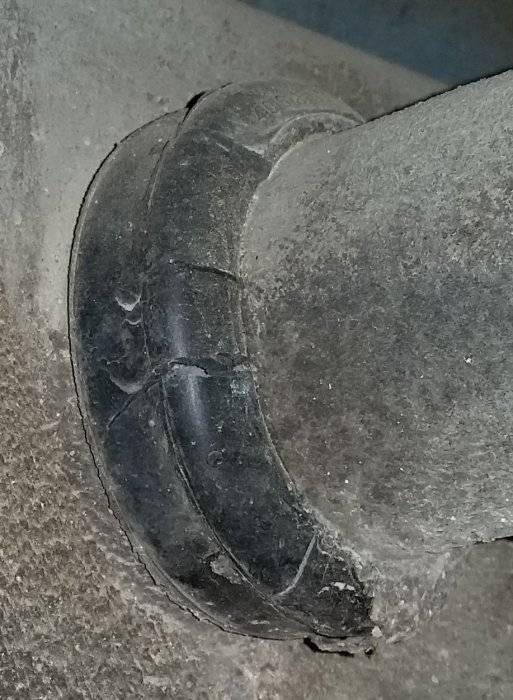

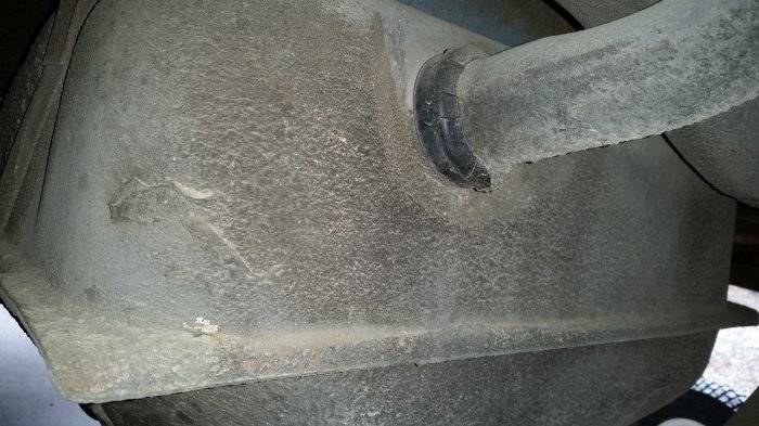

Now that said, I fixed a flat on my ’77 wagon and decided to peek around before putting tire back on.
My fuel tank filler neck grommet is badly cracked:
Pictures do not do the justice needed to show how bad it is.
I do have new grommets in my garage – so no worries there, and surprised it’s not leaking fuel at this time.

Yep, my grommet was that bad when I replaced it. Big chunks missing. I knew I had to fix it before smogging the car. A pretty simple procedure.
