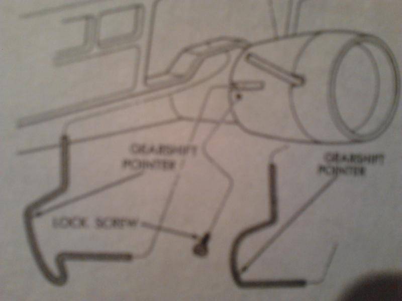

Sorry man... This is the only pointer setup I know.
Crappy pic I know but I had to use my phone.
Pointer slots in...locks with set screw.
Column moves needle.
If yours is different, a pic would help.
Sometimes the pointer breaks off.
Don't know about a (fishing line).
Need pics.
