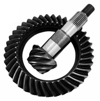

This is an (aftermarket) ring gear and pinion for a Chrysler 7¼”.

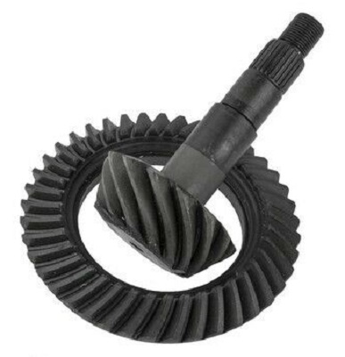

This a ring gear/pinion set for a Chevy 7¼” front differential. Yes, I know comparing apples to oranges, but the reverse cut pattern is the same as the Dodge 7¼” front differential. The ring gear would bolt to carrier and pinion would fit into the housing – but it would be impossible to get the ring gear/carrier to fit into the housing with that pinion gear already in it.

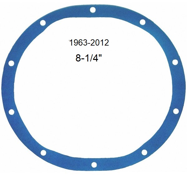

are the 7.25 considered the square cover and 8.25 round?
The 8-1/4” (or 8-3/8” depending on who you talk too) has always had an oval cover (with 10-bolts).

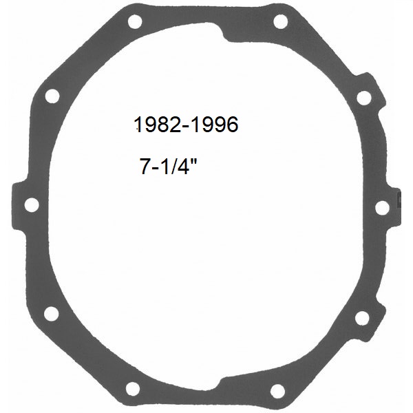

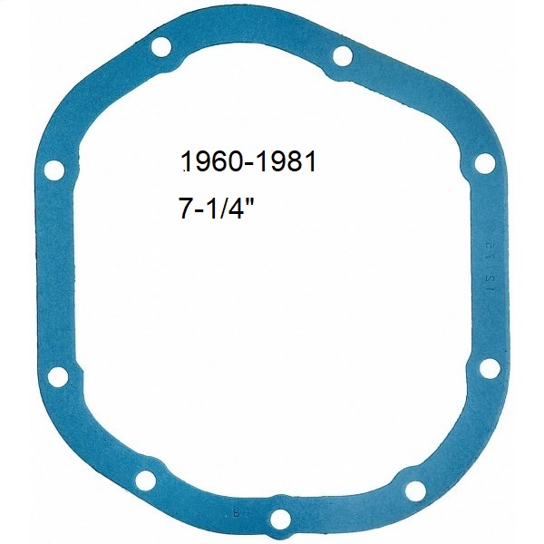

The 7¼” was always called a 9-bolt cover – but Chrysler changed the cover to 10-bolts in ’82 – which tossed that statement out the window.
‘61ish to 81 cover (9-bolt)
’82-‘96ish cover (10-bolt)

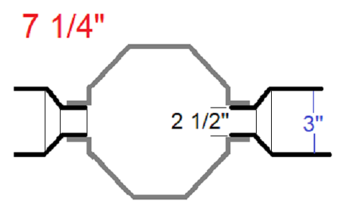

This picture only applies to 10-bolt cover 7¼” (with 3" tapered axle tubes - '82-89).
