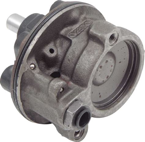

This part of the P/S pump is the same.
The pulley (diameter and offset), the can, as well as the brackets will be different.
Some year /6 P/S pumps create less pump pressure (lighter car, less HP engine) – but I don’t recall the year frames. The reason I bring this up is some people prefer to have less power assist, and swap in a /6 pump for their V8. It doesn’t bother me, either way.
Once the pump is off car, the brackets can be swapped over. With brackets removed, there is a large nut (for pressure hose), that can be unscrewed. Once that is done, the can slides off. I would replace the can seals (large O-ring) for any P/S pump that has been removed from the car – for that is a very likely source of a P/S leak (or potential leak).
