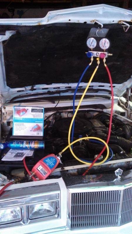

ok, so pulling 22(ish)psi vacuum, going to leave it like that for a while and make sure there are no leaks
with the harbor freight special hooked up it pulls nearly 30psi, but keeps my compressor running non stop, I'll cycle it for a while to get any moisture out, then, on to charging.

22 inches vac is not good enough! It may work for a while but there will still be air and moisture in the system. Any moisture in the system becomes corrosive and will destroy parts. You need to do it correctly or expect to do it again. If the dryer has absorbed moisture from being open too long, or moisture in the system it can plug up or fall apart internally causing valve, bearing or orifice failure. If you get it down to 30 inches and hold it there overnight you MIGHT get away with it.

I replaced the drier right before I did this. The compressor cycles on and there are no bubbles in the sight glass. Feels like it's drying the air, but doesn't feel terribly cold. I haven't stuck a thermometer in the vent yet, but I'm guessing closer to 50, or 60 than 40

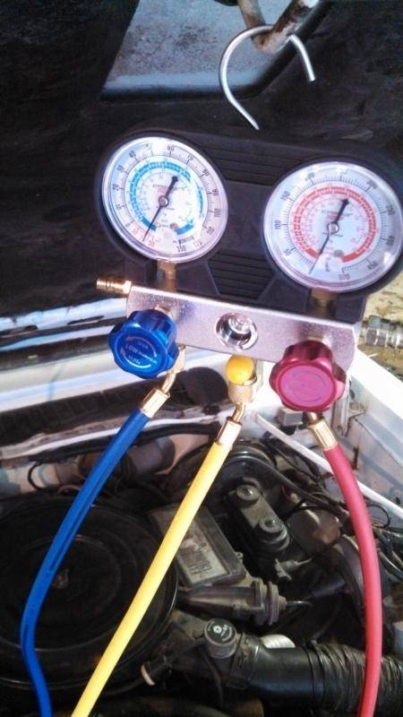

I put the guage on mine and it seemed high, not sure how more stuff could have gotten in there, I park it in the garage so I only used the defrost once or twice all winter.. maybe a valve got stuck? going to have to find a way to make some time time for a half-assed diagnosis on it lol :eusa_wall: tempted to evacuate all the refridgerant and start over..
2,991
That's what we do here at work a lot of the time. Recover the system, evacuate and recharge with the specified amount. Only way to know for sure. More and more lately we do this. Those "home" A/C recharge deals they sell at stores cause all sorts of problems. We find quite a few overcharged systems.

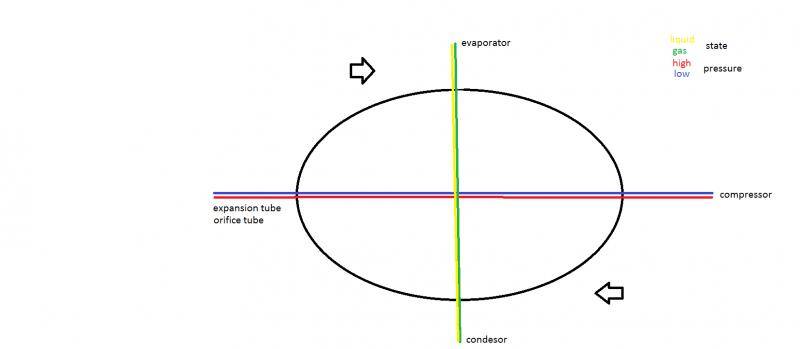

should the compressor be getting hot? If it's been running for 10-15 min. water boils on it!
I don't know if you got this resolved or not, I didn't notice it before. I'm not an expert on it, but from physics, compression generates heat, that's why a propane tank gets frost on the outside of it when it's being used, it's decompressing.. So theoretically that might be normal..
incidentally that's how a/c works, the compressor creates the high pressure"hot" side, and then another part of the system rapidly decompresses it making the "cold" side..
2,991
Yes, the compressor will get hot, very hot, like burn yourself if you touch it hot. The high side lines will be way too hot to touch also. Once it changes state from liquid to gas, it can absorb the heat from the evaporator and send it through the condenser to give up it's heat to the air and start the process over. Remember, air conditioning doesn't make cold, it adsorbs heat so the air feels cold. It's that whole latent heat of evaporation thing, a bunch of physics and to explain it thoroughly would take a couple pages of typing, lol.
