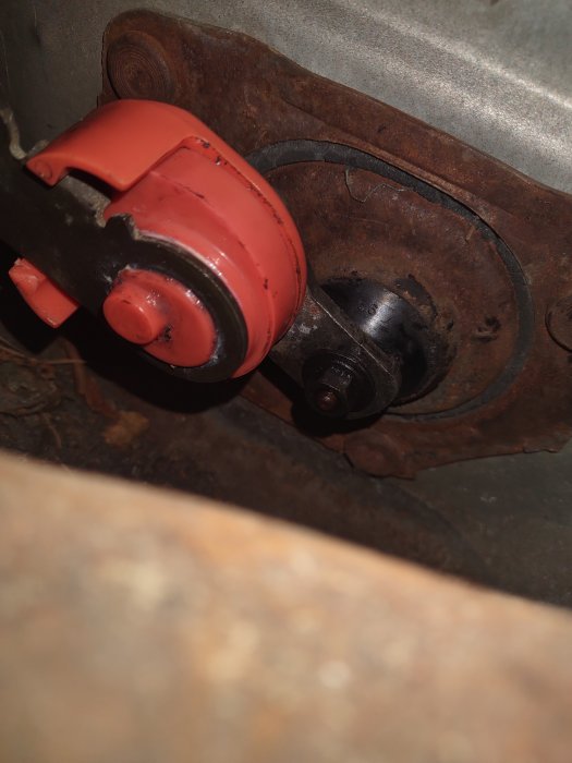

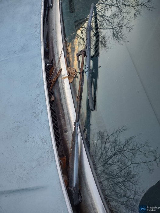

I'd really like to get the wipers working on my Gran Fury so I can drive it without worrying about the weather, but the wiper blades are some obscure trico thing that I don't think can be easily replaced. It looks like it requires inserts. I've got some inserts for it but they're old and probably not the best, I'd rather convert it to a more readily available set where the whole arm is replaced. The linkage is also messed up, someone took the linkage off of the motor and didn't put it back and I have no idea how to hook it all back up. I looked in my 81 service manual but the drawings and descriptions are clear as mud. Does anyone know how the linkage is supposed to hook up, maybe with better diagrams? This is what the assembly looks like

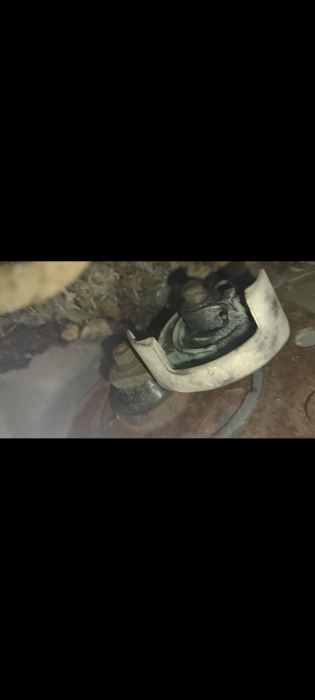

Your Gran Fury uses a plastic cam assy on the motor bell crank. Appears to be missing or broken in the photo. It's most likely the original failure since they break apart after 30 or 40 years. The parts are available, just have to be sure you get the correct ones. IIRC, there's 3 or 4 different p/n's
I'm new to this forum. I'm looking for a replacement intermitted wiper cam assy that is attached to the wiper motor. Could someone please tell me where to find one.
Look on eBay, there is a vendor that makes a bunch of the wiper cams for old Mopars. I will look at my eBay history and try to find his user ID
