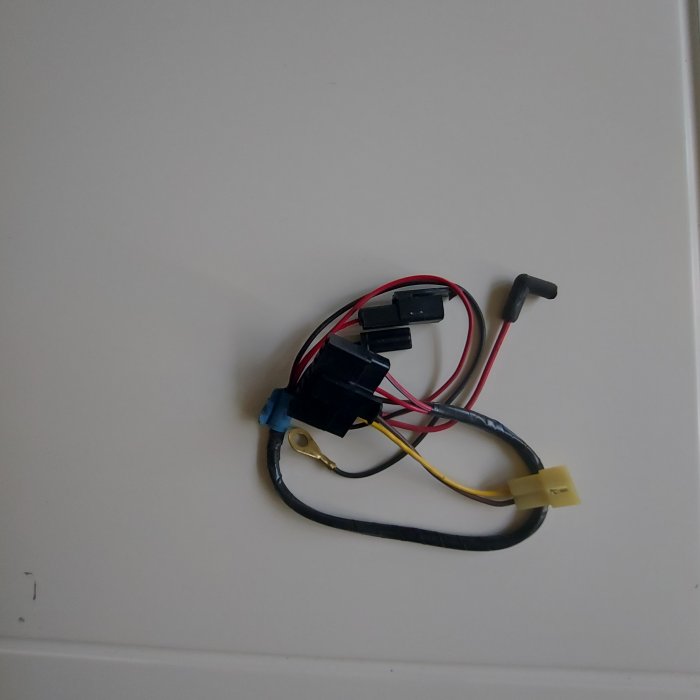

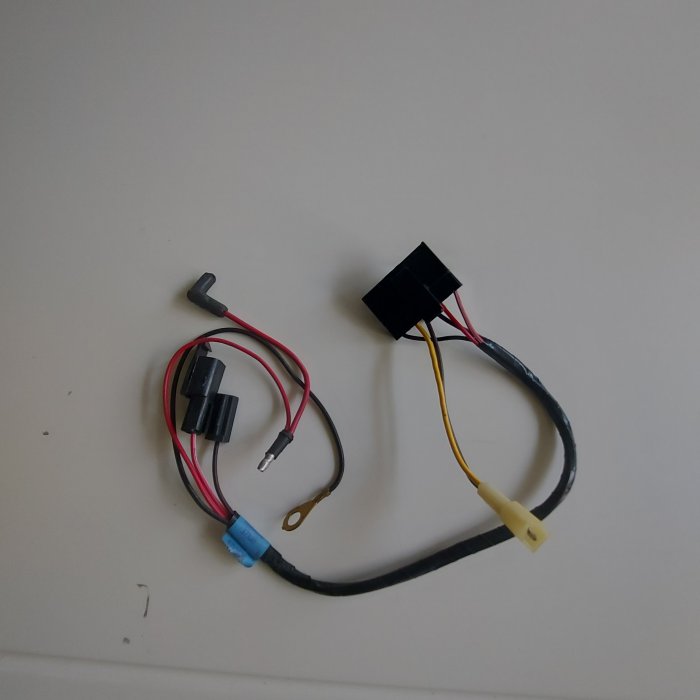

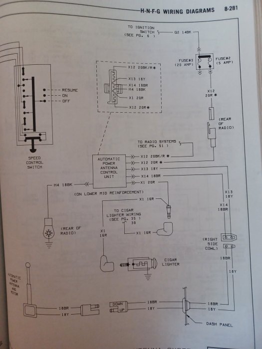

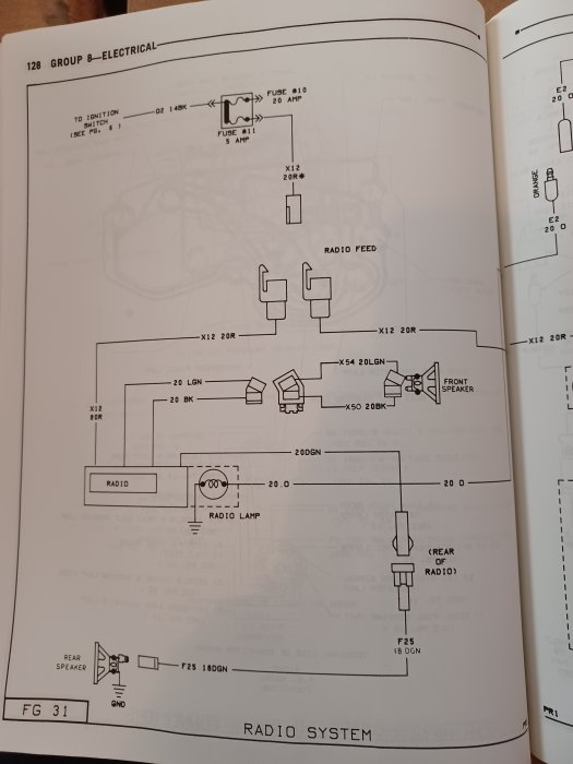

An unclear scheme I made for my own memory and simplified
Mikes5thAve
Mar 3, 2020
1,785
739
It doesn't feed to 2 different fuses like your diagram shows. The X12 20BK/R goes to red wire of the radio which was previously connected to the fuse. Which is where the X12 20R wire now connects.
Gunnar Schroder
Apr 22, 2023
119
47
Norway and Sweden
Sorry Mike for dropping a clanger. The original red was already connected aleady to fuse 11! I am looking forward to checking it over on wednesday. So the other from the Contol box just connect up with the one already in use?

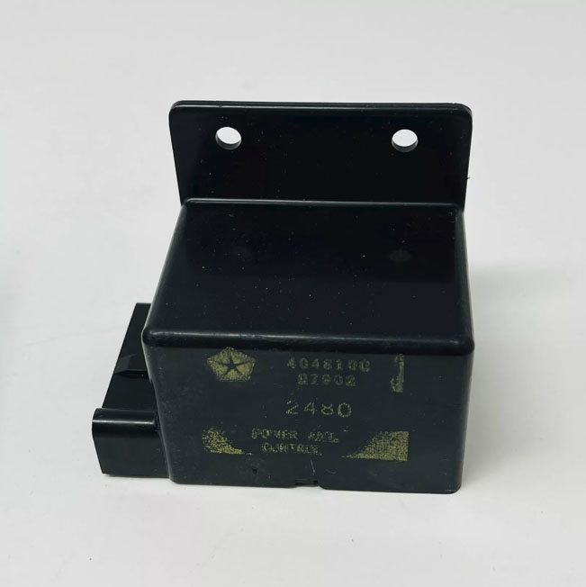

Time for updates before winter sets in:

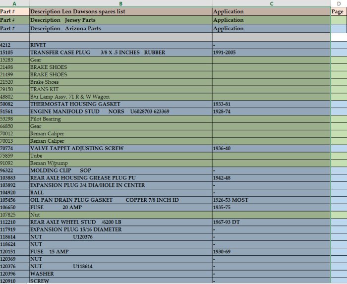

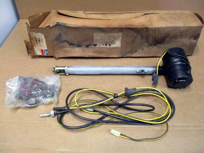

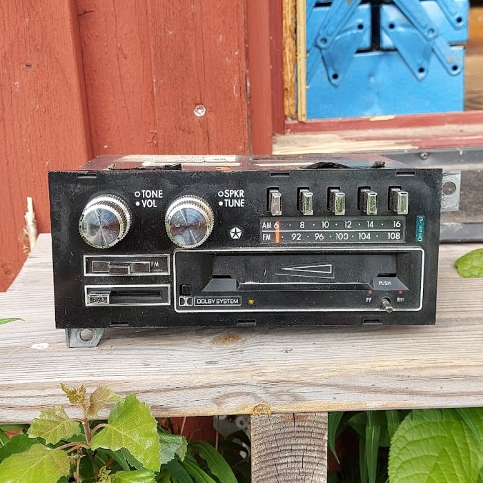

I have found several other parts for the old girl. Thanks to Arizona Spares I found the Antenna control Box pluss several other small parts. Excellent service and helpful.

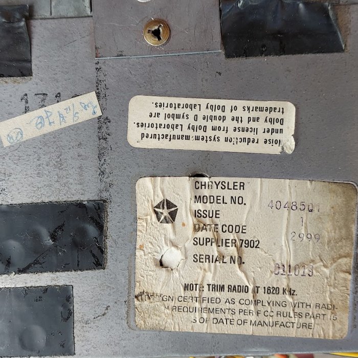

Now to the radio again. It works splendid with the fixed antenna. No problems at all as that was what was in the car when I got it.

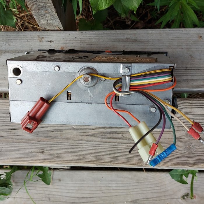

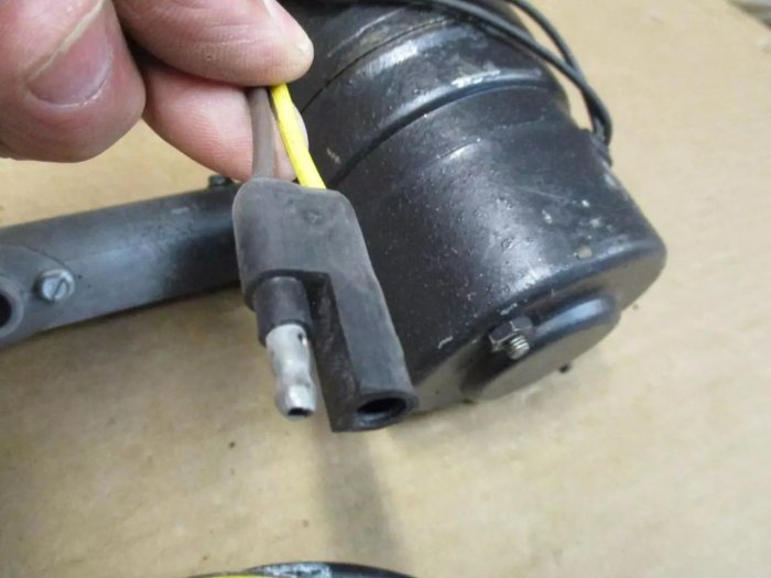

A different kettle of fish will be to get hold of the original connectors to make a perfect restauratin.

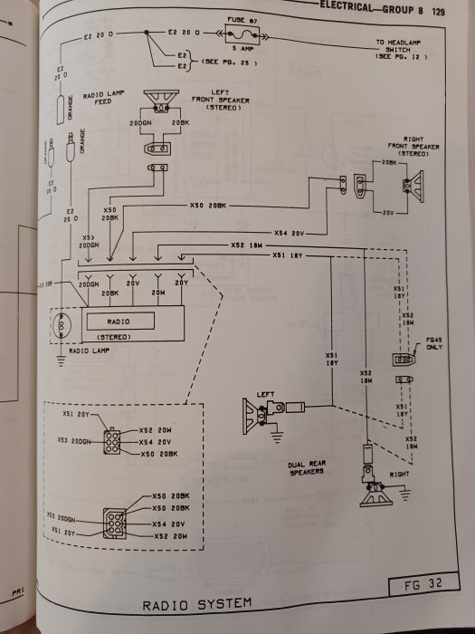

For that reason I am looking for the old style connetors. A small glimpse may be seen from the attached photo; the brown one to the left and the white one in the middle. Another one
that I am after is a 6 pole one (Male and Female) for the speakers.
If anyone of you have a clue of where to lay my hands on them please advice me.
