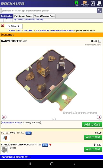

Does it crank or not? What wire? Stops the fan... the blower motor? There's something missing here that doesn't make sense.
If you want to throw a parts cannon at it you can try this
But there's more going on here I suspect. Mouse chew any wires?

Can you hear a click when you turn the key from under the hood? If so the starter relay is probably OK. Do you hear any noise from the starter? It could be going bad. If the lights dim when you try to start it chances are good it's the starter.
But also check all the connections at the battery and the starter in case something is loose or corroded.
If it cranks but doesn't start there's something else going on either ignition or fuel related.
