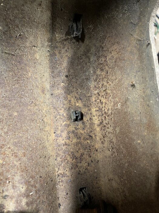

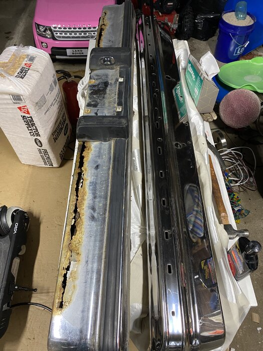

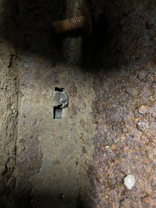

As I await bearings and calipers in the mail I decided to tackle the rear bumper removal. I got one that a guy had rechromed years ago but never got it mounted. I painted the inside as it had a good deal of surface rust and waxed the chrome up. Not perfect- but still will outclass the car! Anyone know how to remove the rubber trim clips form inside the bumper? Not a big deal but just in case I thought I would ask!
Gently squeeze the little tabs while simultaneously pushing them out of the bumper. You may be able to get them by hand but, a pair of pliers and a gentle touch will help...just don’t squeeze so hard you accidentally mangle the tabs. I have a extra nerf strip for the rear bumper in my garage, you’re welcome to it if things take a turn for the worse.
Also, either get new bumper bolts OR use lots of penetrating oil before attempting to remove your old bumper bolts.
Put lots of penetrating oil on the nuts that hold the bumperettes on either side of the license plate on. They like to rust and tear out of the rubber part. The black strip is easy to get off once you figure it out.
Thanks - yes my little one’s ride haha the only car that runs in the garage... I got the pieces off, only one plastic peg snapped... bumperette nuts solid piles of rust... may have to use grinding wheel in the drill or something... then screw them in from behind or something...

Do you have a heat-gun handy? If yes, play with the heat setting a little bit, but that should make the plastic a bit more flexible...heck, do not melt the darn thing, just make it more pliable.
Thanks I did use a lighter on a few of them! Not as good as a heat gun but it worked ... back to brake work then hopefully I’ll finish the bumper up... anyone know if bench bleeding needed on new master if I will be replacing calipers and wheel cylinders anyway? I think I will do it - can’t hurt...
