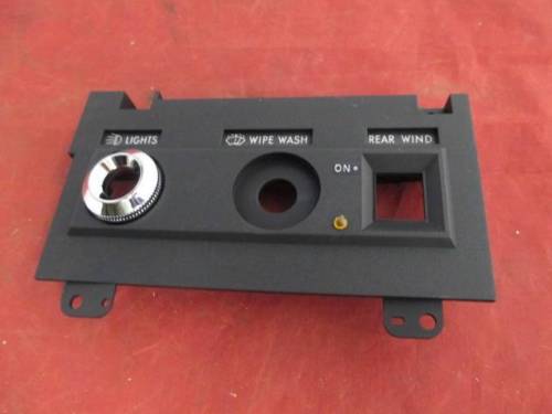

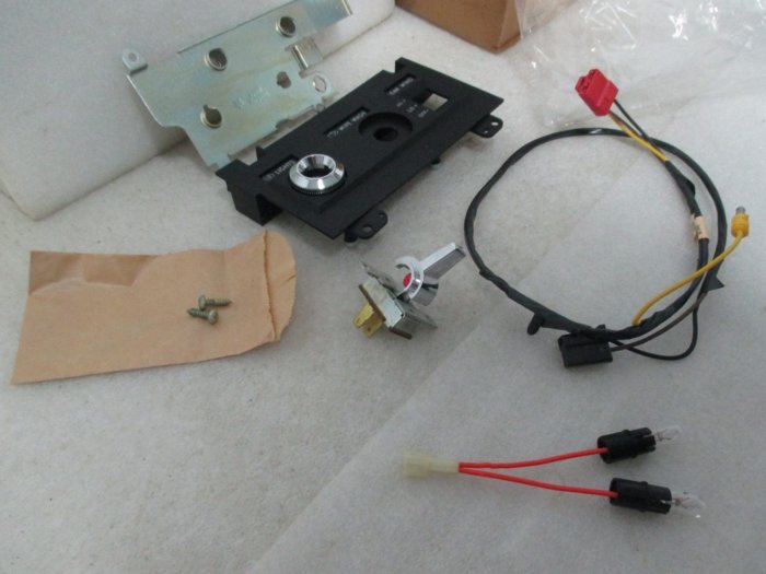

The eBay listing is for the Defogger (blower motor style) and not the Defroster (electric grid style). Those two terms “Defogger” and “Defroster” are so close that even I get confused at times.

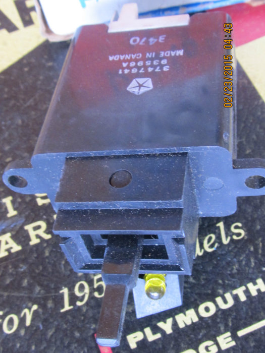

The main switch looks like a blower motor switch - well, because it is for a blower motor.
This is a picture of an ’80 M-body Defroster switch – which I think is about the same size/shape as a F-body one is.
They have a relay as well as a timer built into them. Most of all of the newer switches are push-button and all of them has gotten smaller over the decades.
Pictures were swiped from eBay.

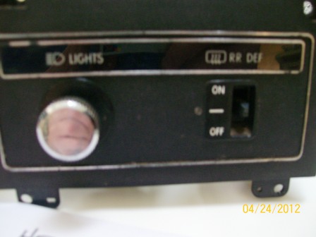

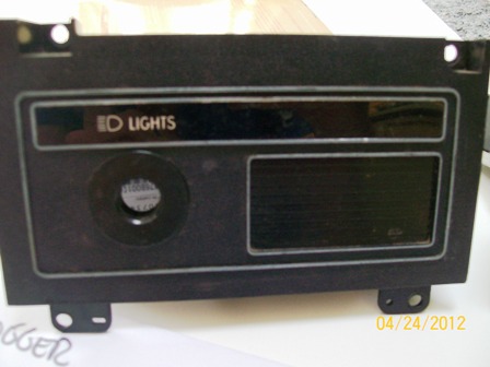

XfbodyX
Sep 9, 2015
1,713
487
Central US

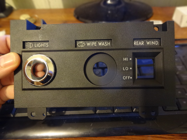

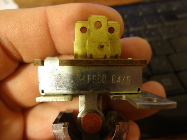

The defog vs the defrost switch look the same but have a different pn, same connector. But the same basic switch, the ebay one looks like a non mopar replacement.
But they look nearly the same and both uses use different PN-s but are the same basic parts. Why did they do this? Beats me.
This is the rear DEFOGGER Switch and Bezel. Next post is the defroster.
Switch PN 3746960 in the parts book and stamped on the switch itself.
The bezel for the defroster is PN 3746953 and does not have the yellow power on indicator light.

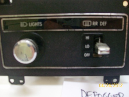

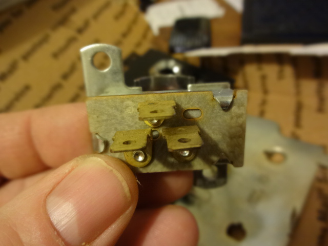

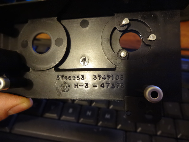

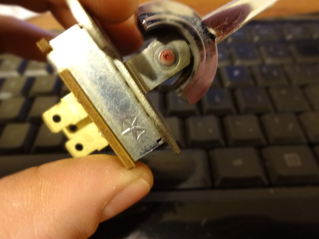

XfbodyX
Sep 9, 2015
1,713
487
Central US
The rear defroster uses the same bezel with the second PN on the rear 3747106 with the yellow light for the power on.
That switch used is the 3746958.

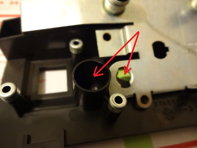

You can see by this ebay pic, this is the bezel with the power on light.
You can see on the back where the light bulb goes both in the bezel and the backing plate.
Probably illuminated from a lead from the relay.
